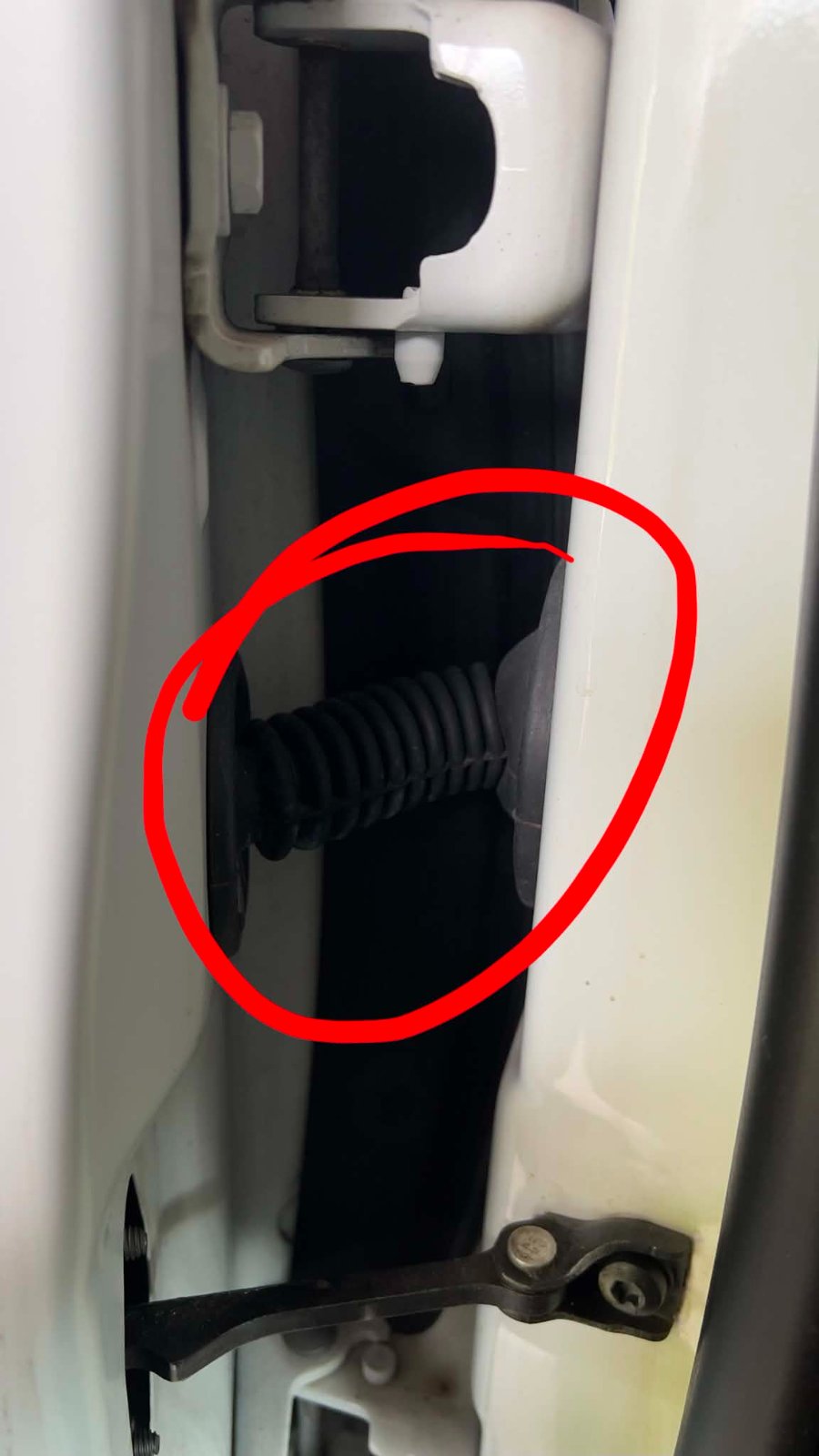

Check the wiring at the door hinge. :)

mickthemaverick wrote: 17 May 2026, 20:33 Check the wiring at the door hinge. :)
this?
Posts: 20312
x 7852
Re: DS3 2015 PROBLEMS LOCK & UNLOCK
Yes, carefully slit the boot so you can check for broken wires inside. Tape up properly when you are done. :)

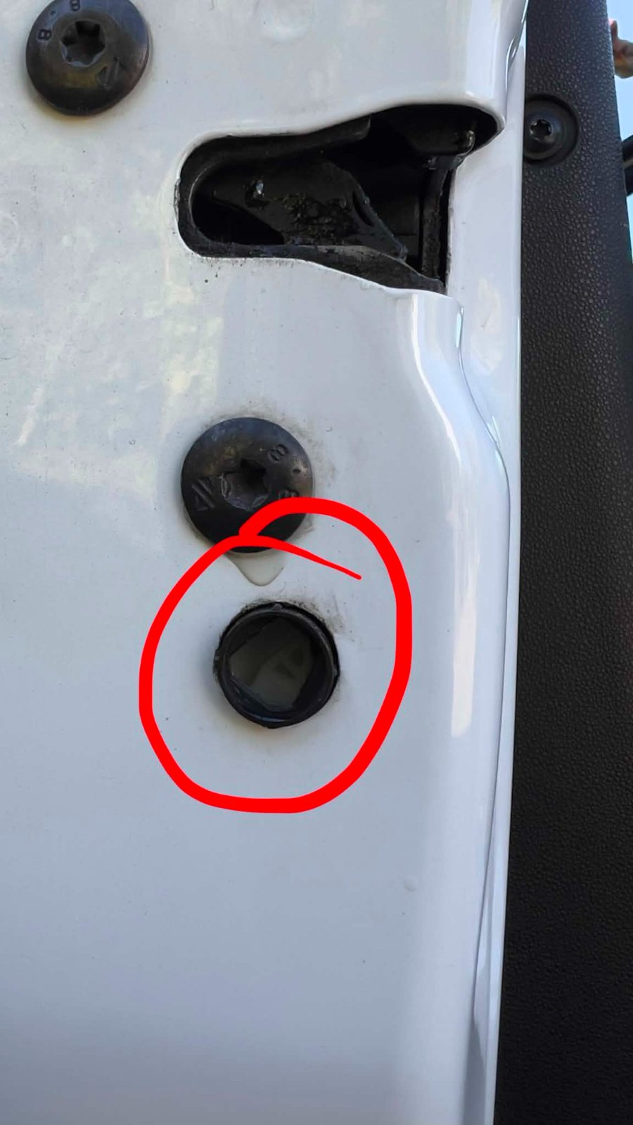

Well, update. Checked the wires everything ok. Check that (photo attached) move the thing with the key and start to work... so or was just stuck, or the lock system is going to die. Or something... frenchs eheh
