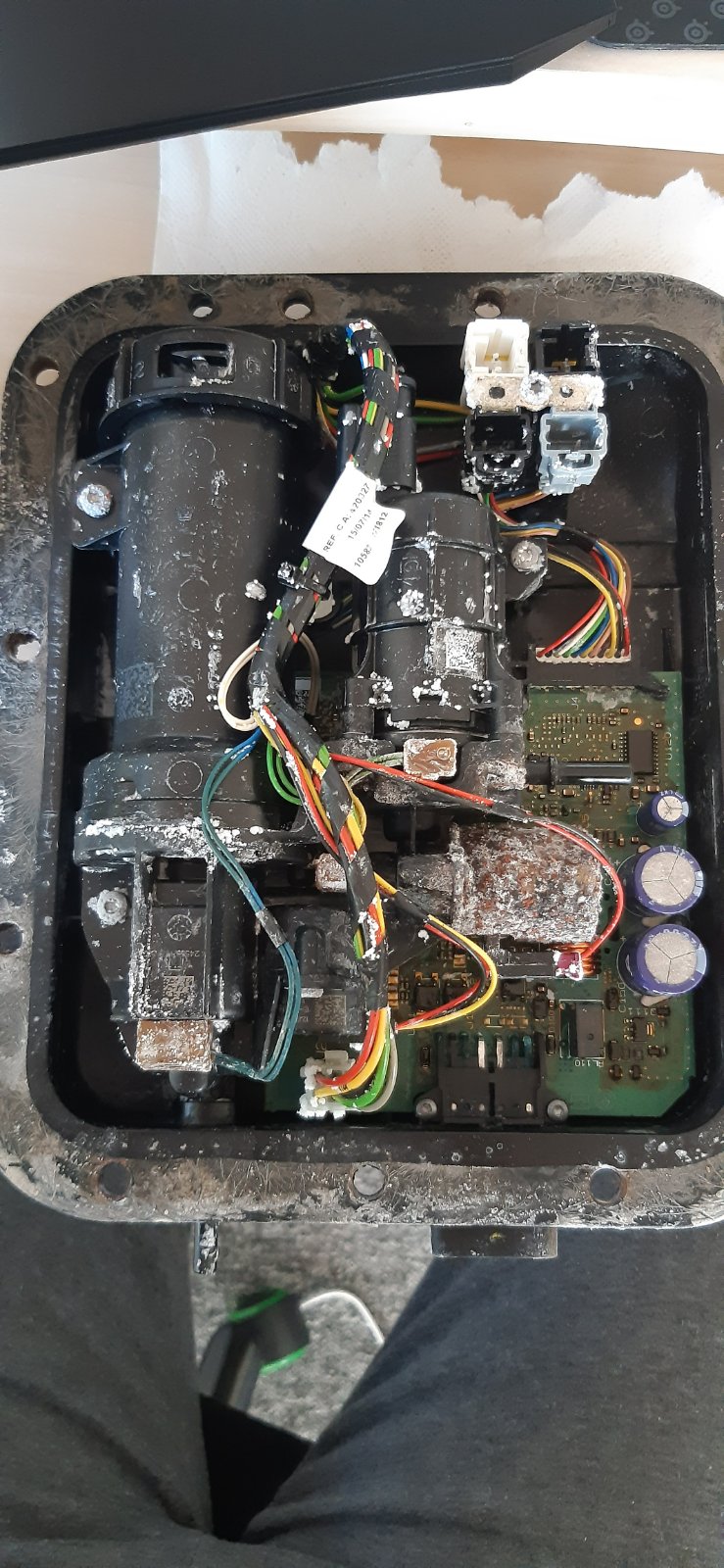

I’ve been getting AdBlue tank errors (low pressure, etc.). I removed the tank, disconnected everything, and found that the AdBlue pump module was flooded with urea solution. The PCB has corrosion on some component pins.
I tried cleaning everything, hoping it would fix the issue, but after reassembling and plugging it back in, I now get error U029E (no communication with NOx system). I suspect there’s a short somewhere on the PCB.
I started looking for a used replacement on eBay and noticed that my PCB has 3 capacitors, while other versions seem to have only 2. After reading more (and checking some forum links), it looks like there are at least 3 different firmware versions of these PCBs. Even if they look the same, they might not work properly with my car’s CAN bus.

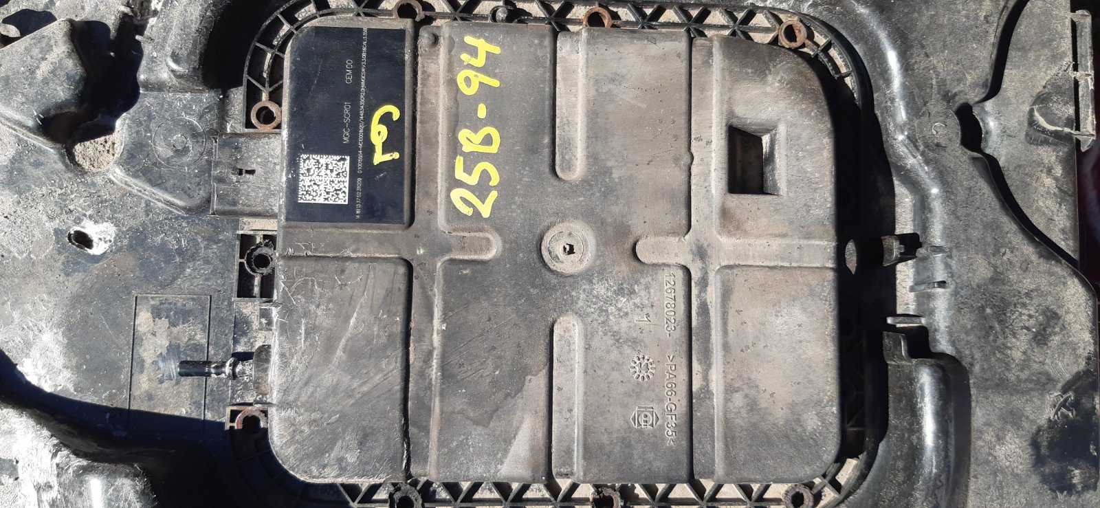

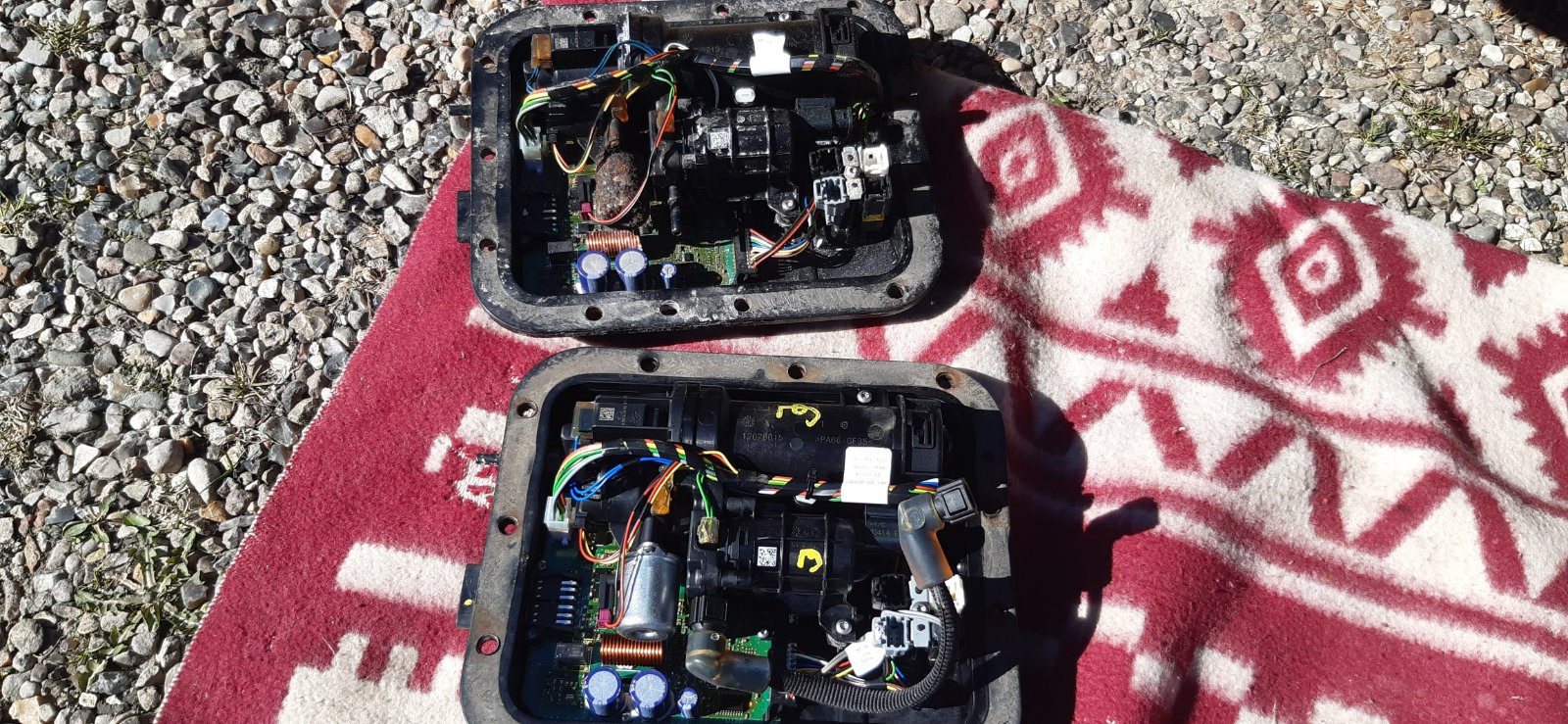

Re: ds3 1.6BlueHDI adblue compatibility issue
Solved
I have found adblue module on Car Recycling shop spare parts. Surprisingly Peugeout 308 from 2014 year, 1.6 bhdi has that same module as mine, 3 capacitors on pcb and that same numbers on adblue tank and pump module.
Visually the adblue tank from Citroen c4 cactus 2014 is that same, I presume adblue module as well.
It works, I have just pluged it in and have erased erros and have reseted the settings via Delphi adapter (refiill add blue).
I hope no any worries I will get regarding it.
I have plans to take a tank off somewhere in fall time with upcoming cold for inspection.
