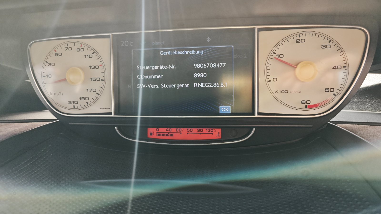

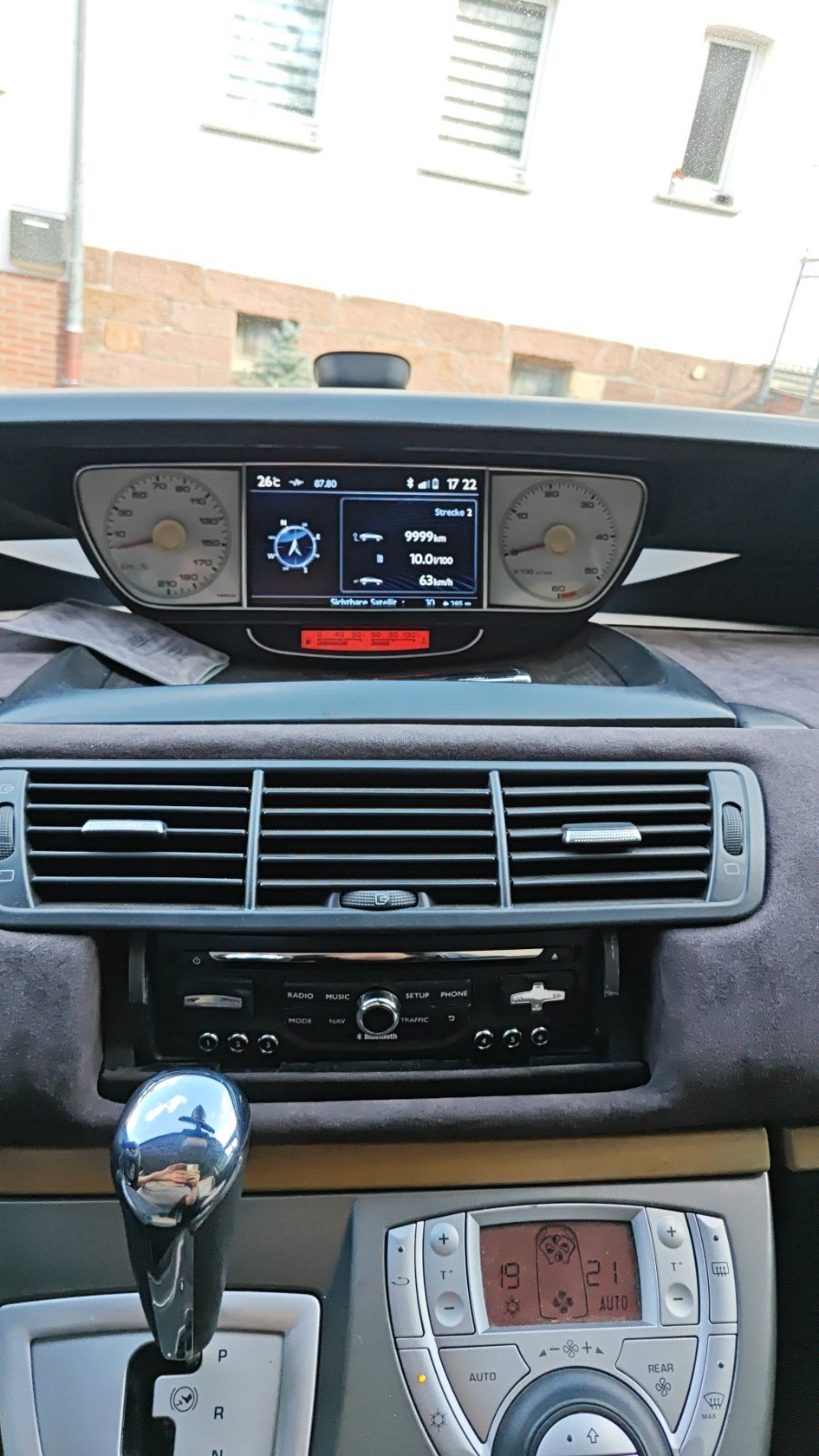

Hello, I am new here. I am familiar with Peugeot 807 and Citroen C8. Now I bought a Lancia Phedra with full Specs. It had a RT5 HDD navigation. I like to keep it factory no China Android aftermarket Radio. Bit would like to have a updated Navigation system. So I bought a RT6 RENG2 (lastest updates)and a new Display spend almost 900€. The seller coded my VIN to the Radio unit. I installed everything and it turns on (with a Citroen Logo :-D ) I don't mind. Controls are working and it all the other information are correct displayed. But hand here is my big problem the trip computer stuck on the old range and fuel consumption from the old nav system. I filled up Diesel and nothing changes. Any ideas ? Thank you!

I checked my software version it's 2.86B1. so no calibration needed, correct?

Okay it worked out fine ! Just had to , connect and disconnect again
