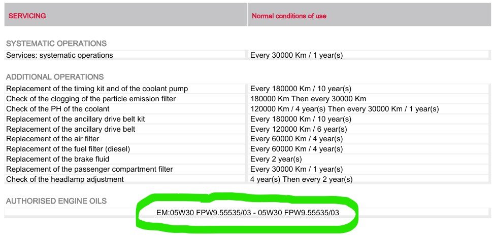

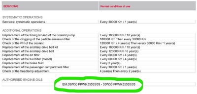

I did my research, and judging by everything I saw, for my engine I should be using 5W30 Oil FPW9.55535/03 (judging by viewtopic.php?t=75918 and other topics I have found and read). Is my assumption correct?

Time for a new oil change, so just double checking. Is 5W-30 FPW9.55535/03 still the recommended oil for my engine?
