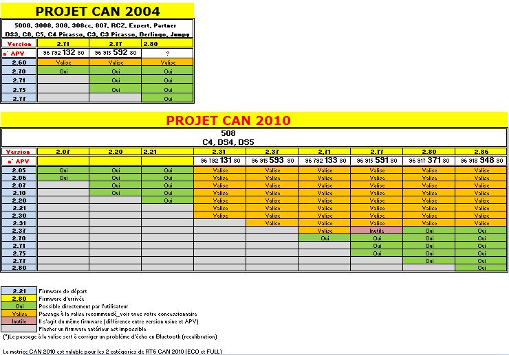

This update map would seem to show that 2.75 to 2.77 is OK. Note that there is no 2.75 as a destination firmware version which confirms that it was not a public release.
