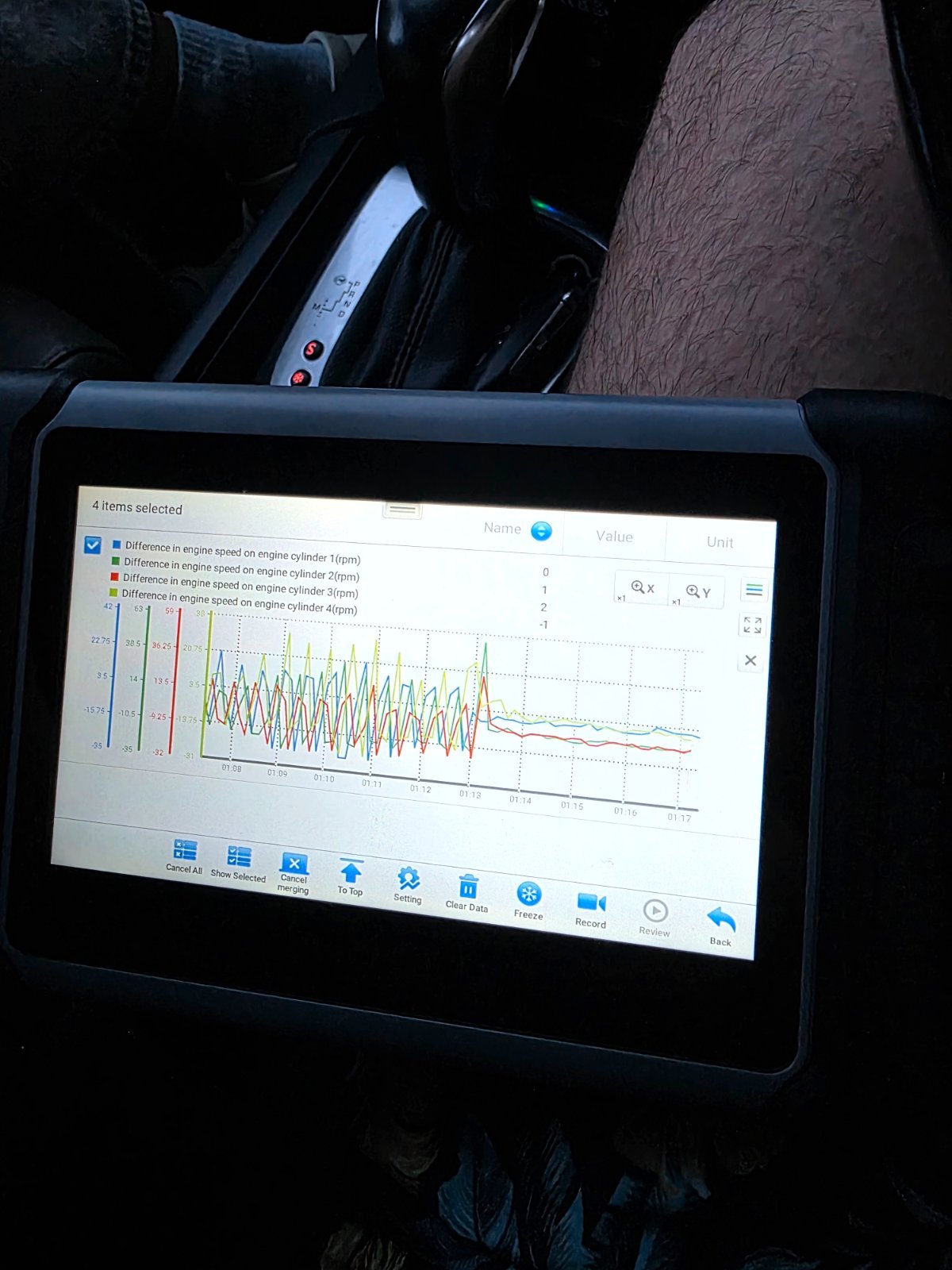

Graphs from the diagnostic tool show unstable rail pressure at idle but become stable around 2000 RPM

Re: Fuel Heater Control Open Circuit
Assuming the noise in the video, chuffing, is the result of the problem it sounds like it is related to a piston pump with a leak to me. The obvious choice being the fuel pump and maybe a vacuum leak? :)
