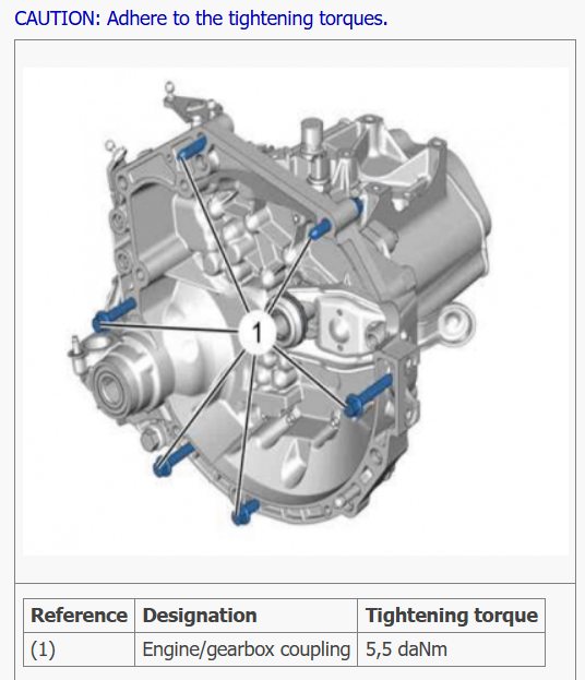

Hey guys,
I'm in the process of changing my transmission-side crankshaft seal and I just removed the gearbox. Before I touch the clutch does anyone have any tips or things I should look out for during removal/refitting? I was also wondering if anyone has torque values on the bolts holding the transmission and the block together. (The ones marked on the picture below, the picture is of a mk2 citroen's gearbox)
Thanks
