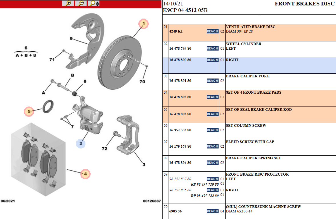

Re: Berlingo K9 front brake sizes
Unread post by wheeler »
Looks like you have 304mm brakes
Part numbers as shown

Very good of you, thank you.
Do you know, perhaps, if there is a pattern behind the various sizes available?
