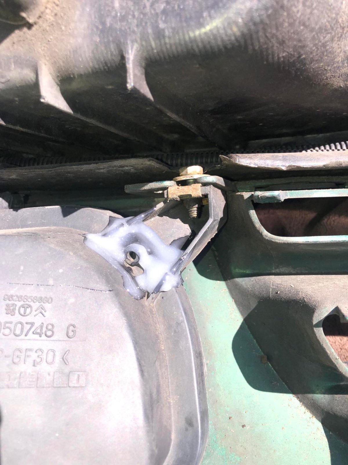

Well I thought I'd better make an effort to keep her looking pretty, the fog light wouldn't sit back in the correct position and I could see through the gap that the inner bracket was broke :cry: That meant having to remove the bumper ...
Skull's - Bumper 'popped off'
Damaged bracket after removing Fog Lamp fully to allow locating tab (arrowed) on bumper to be re-inserted squarely onto fog light slot/brackets - it needs to go on square before fixing and had been forced out of the central locating tab, which was why I couldn't realign the fog lamp without removing the bumper!!
Skull's - Damaged Bracket
Araldite
Skull's - Araldite repair
Fog light realigned and bumper 'popped' back on ... only 5 hours so far...paint needs a rub down and touch up ...TBC
Skull's - Reset Fog Light awaiting paint

That is so annoying Skull :evil:
Still, on the plus-side at least the foglight lens escaped unscathed - that was a bit of luck ;)
And that's a great repair :D I think, on that basis you can continue to attend concours events :cool:
