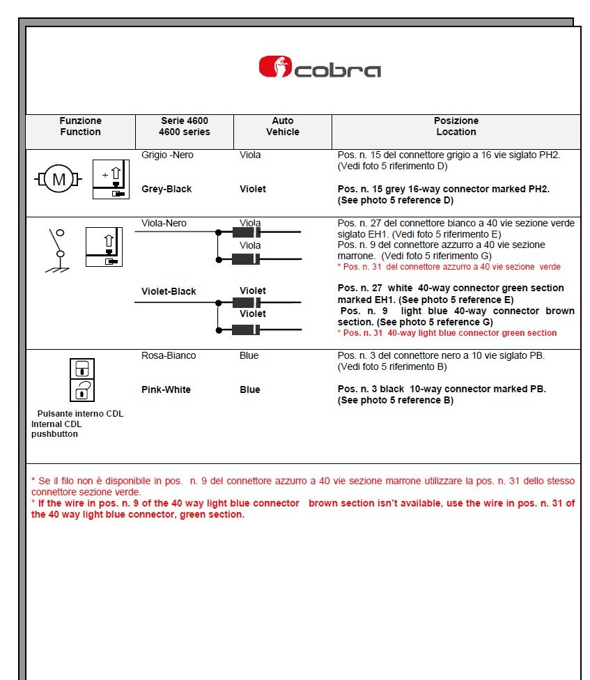

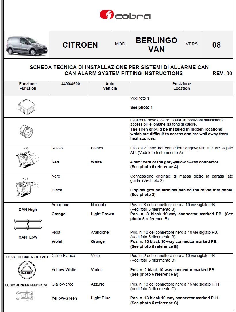

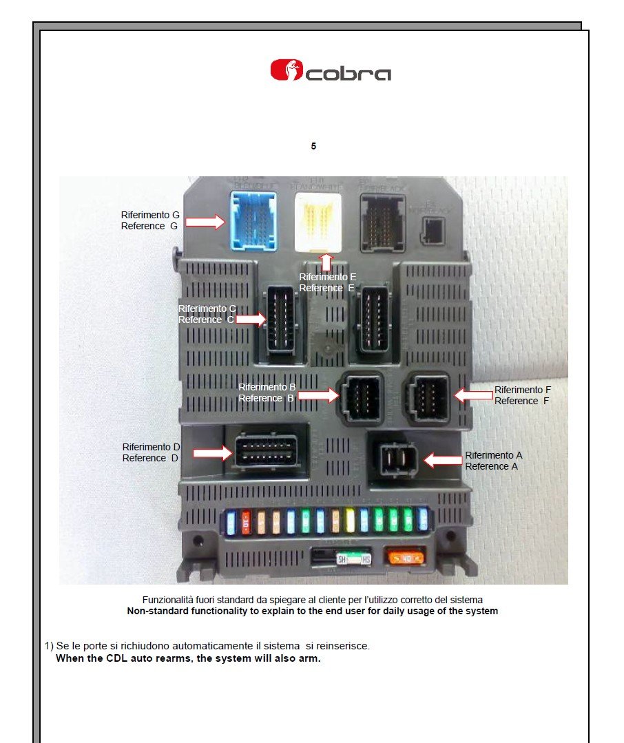

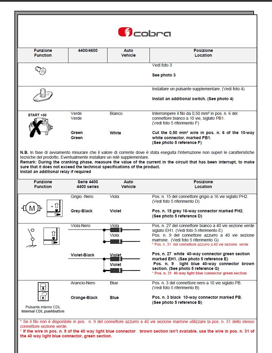

To kick it off I seem to be having some issues installing a Cobra 4600 alarm into our 2012 Citroen Berlingo van (micro camper conversion). When we bought the van it was only supplied with 1 manual key so to keep things simple I opted to fit a Cobra 4600 as I have fitted a few of these and they have been rock solid, it also means we can use the cobra remote in absence of the missing Citroen remotes.
Cobra / Vodaphone were very helpful supplying a wiring diagram for the BSI but I still cant seem to get the CDL working off the Cobra remote and the alarm only flashes the O/S/R indicator and non of the others, has anybody had any similar experience? Ive added the cobra wiring diagram supplied just in case any of you can see any errors.
