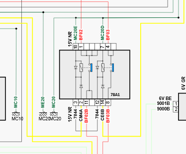

The ESP / ABS Diagram in this thread viewtopic.php?t=84455 seems to match my car.
However I wonder where to find component "78A1"?

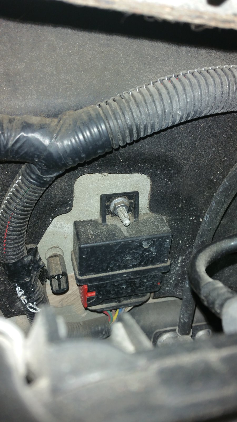

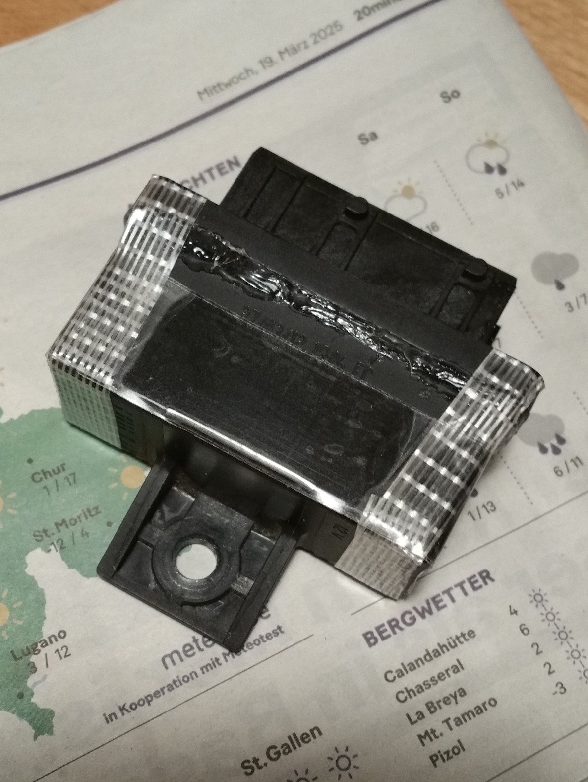

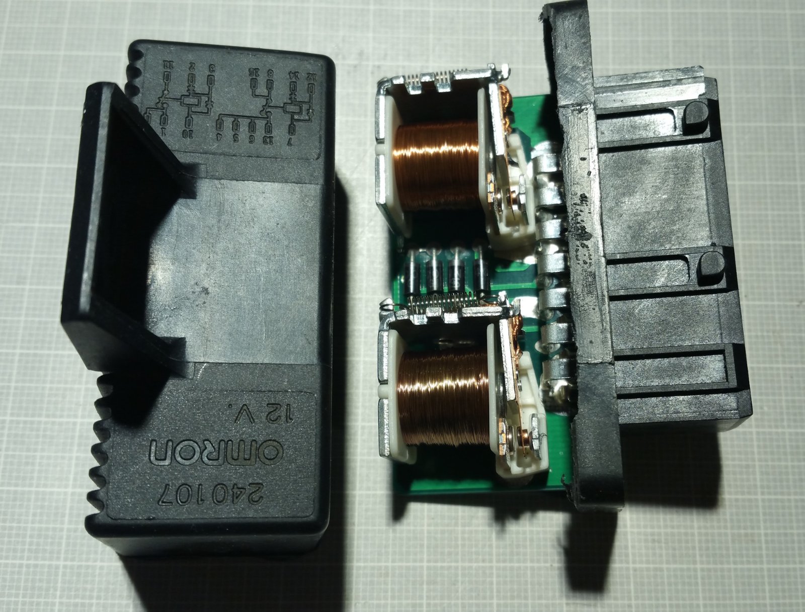

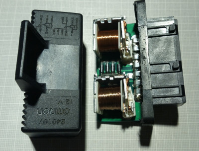

Never mind, I found it! 78A1 is a dual relay, bolted to the firewall behind the engine. Omron 240107, fully sealed, but I cut it open anyway. Both diodes on 2 and 14 were open. I replaced them, put all together with hot glue and tape and the car is back on the road again :-D
Many thanks to Marc for the wiring diagram!
78A1 on firewall
78A1 on firewall
