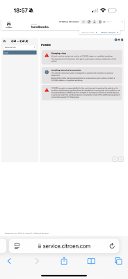

I’m unable to find a fuse list on my c4 manual. It literally just has text for changing a fuse, installing and no responsibility but there’s no breakdown on which fuse to check.
I’ve seen diagrams online but not sure which one applies to c4

I’ve attached from the electronic manual. Just says this unfortunately. This is from the link kindly supplied and also matches the wording in the manual I received electronically.

How different is a C4 to a C4/C4X, I wonder? That manual does include info on the fuse boxes.
