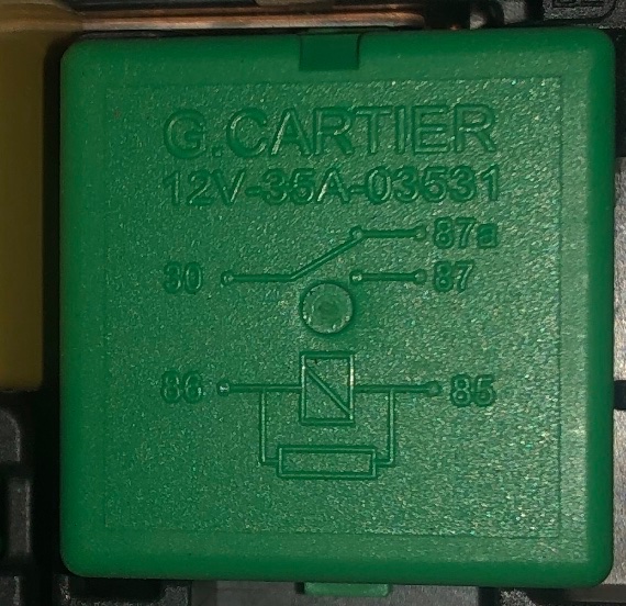

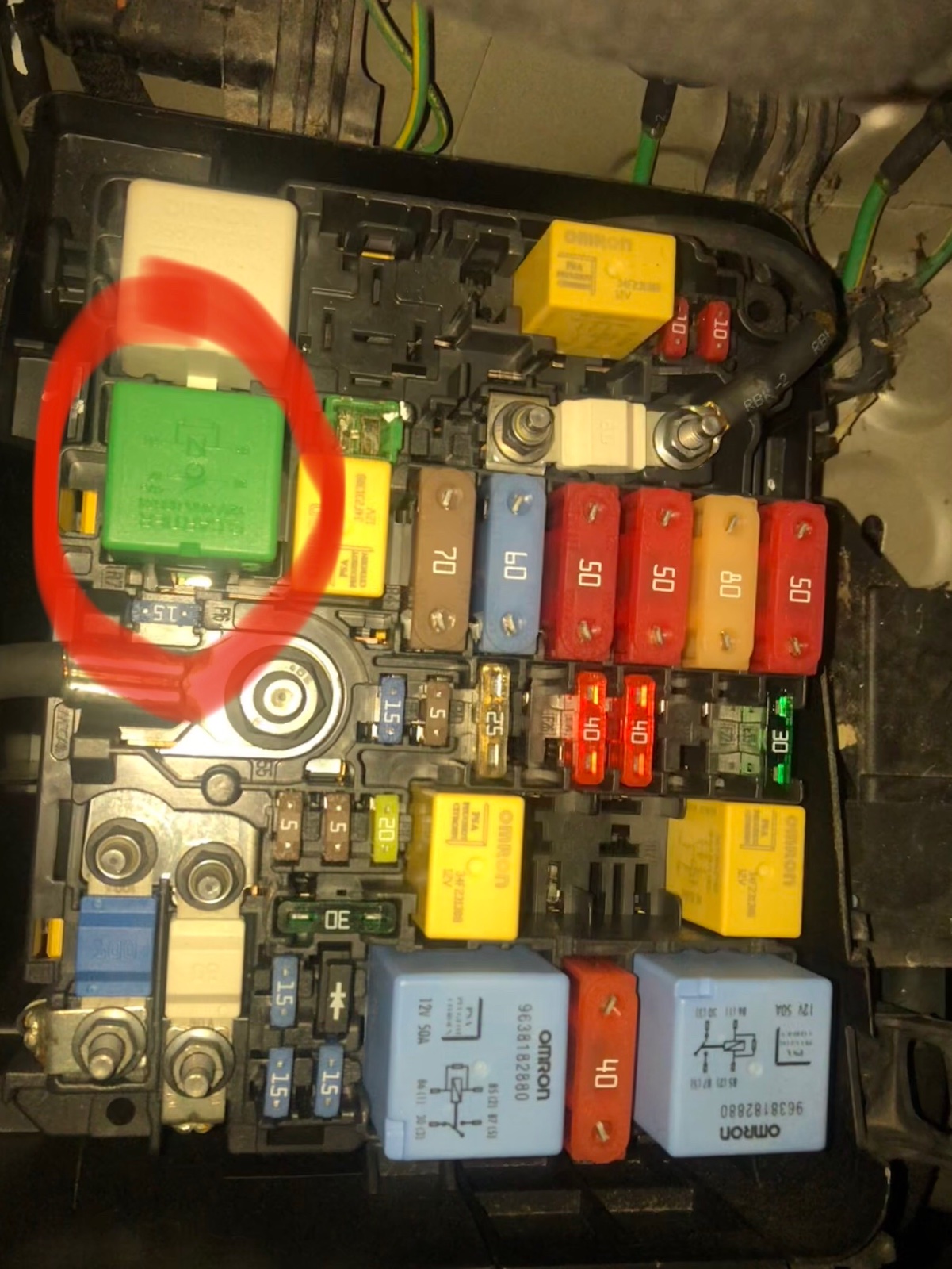

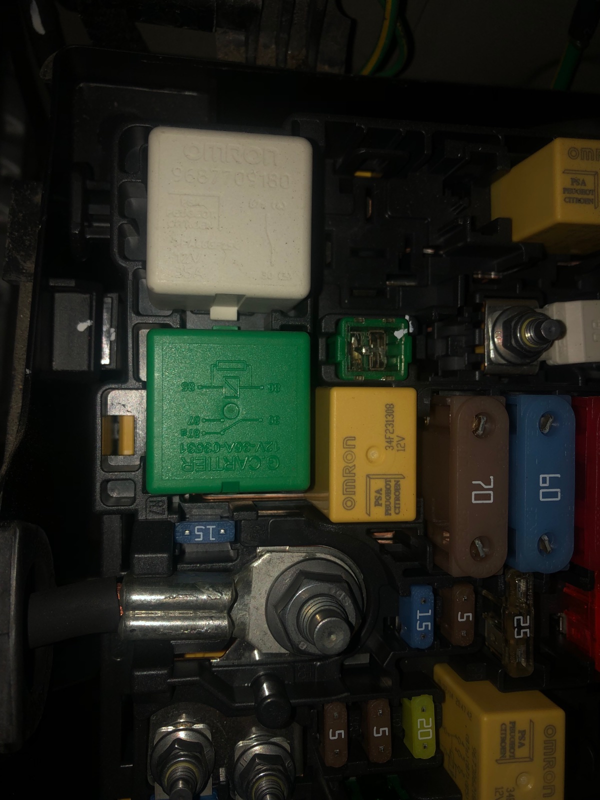

I think I’ve located the relay in the fuse box by the battery… it’s the green one… marked G CARTIER 12V 35A 03531… part number is 6547TX from another post so ordered it and will see how it goes… after this I will have to try the resistor… fan is still intermittent and was on again tonight before knocking itself off.
