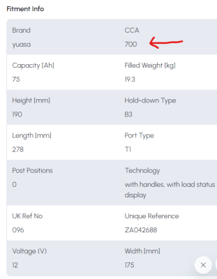

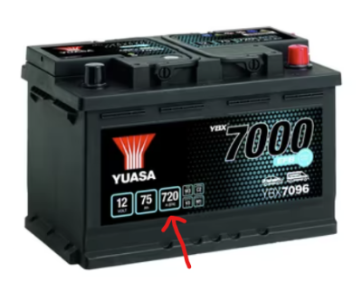

Regarding YUASA:
The lower parameter is the cold cranking power.
It would depend on how much cranking ampere the engines starter actually needs.
Sometimes this required power is on the sticker which also lists the tire pressure (on the driver side door frame).
No idea if the electrical fuse of the starter would be of any further guidance.
Besides that the battery capacity is actually bigger (75A compared to 70A).

Regarding YUASA:

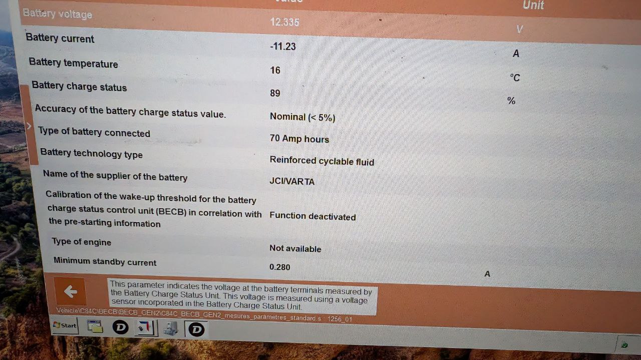

Alright so I did some further digging today with Diagbox and "Launch Creader Elite 2.0 handheld device".
First I used the Launch device to simply read for errors and I also found an option regarding setting the battery type. Originally there was no value so I set it to "sealed VRLA/VRLA2".
Anyway, that didn't fix anything and I couldn't find much more promising options (except also a disabling stop start option).
So I continued with diagbox and found some interesting things.

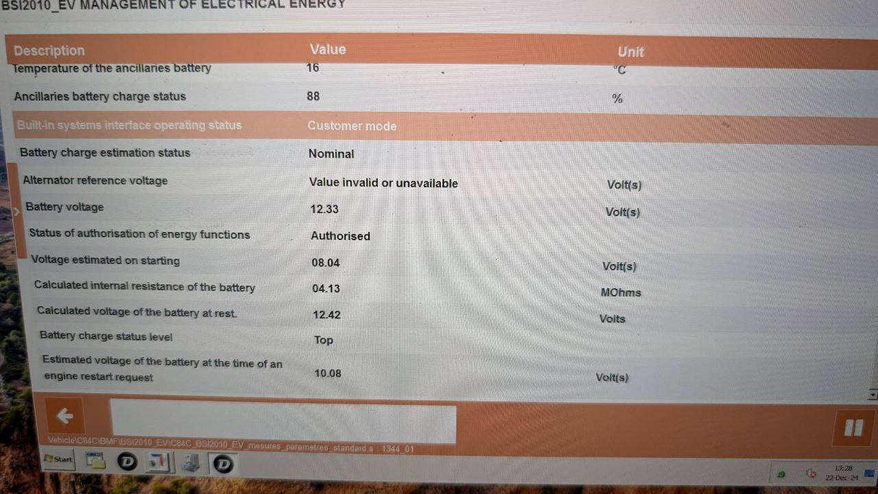

Here you can see some general information about the battery. The voltage is low and the the battery charge status is at 78% but that is after already standing for 20mins with ignition on and diagnostic tools attached.
What I find interesting is the status of "calibration of wake-up threshold of the battery" and you will see soon why.

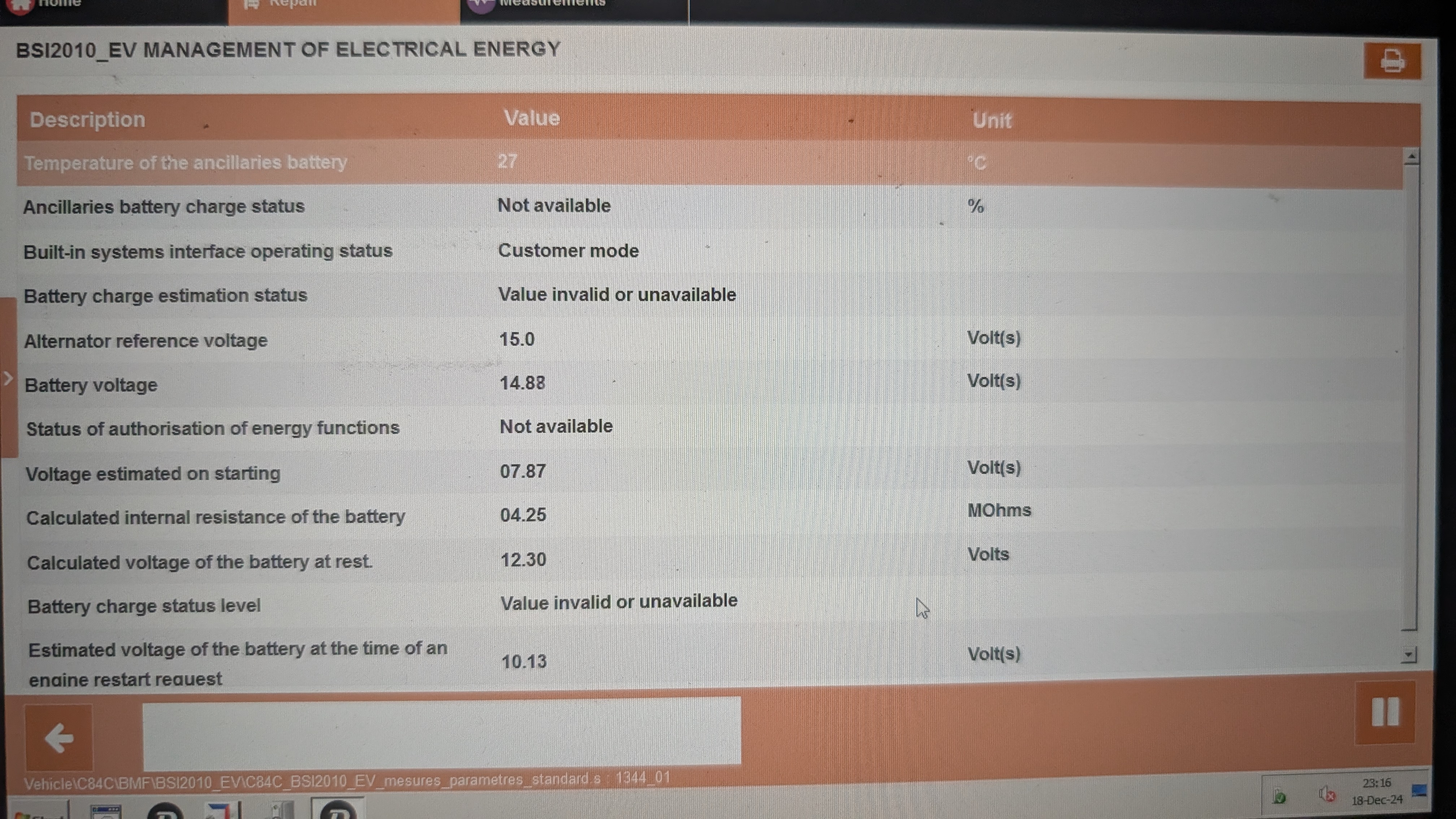

Because here is the next screenshot (which I made while the engine was running) and it shows that the battery charge status is invalid and that the estimated voltage for an engine restart is at 10.xxV.
This is absolutely wrong and weird?

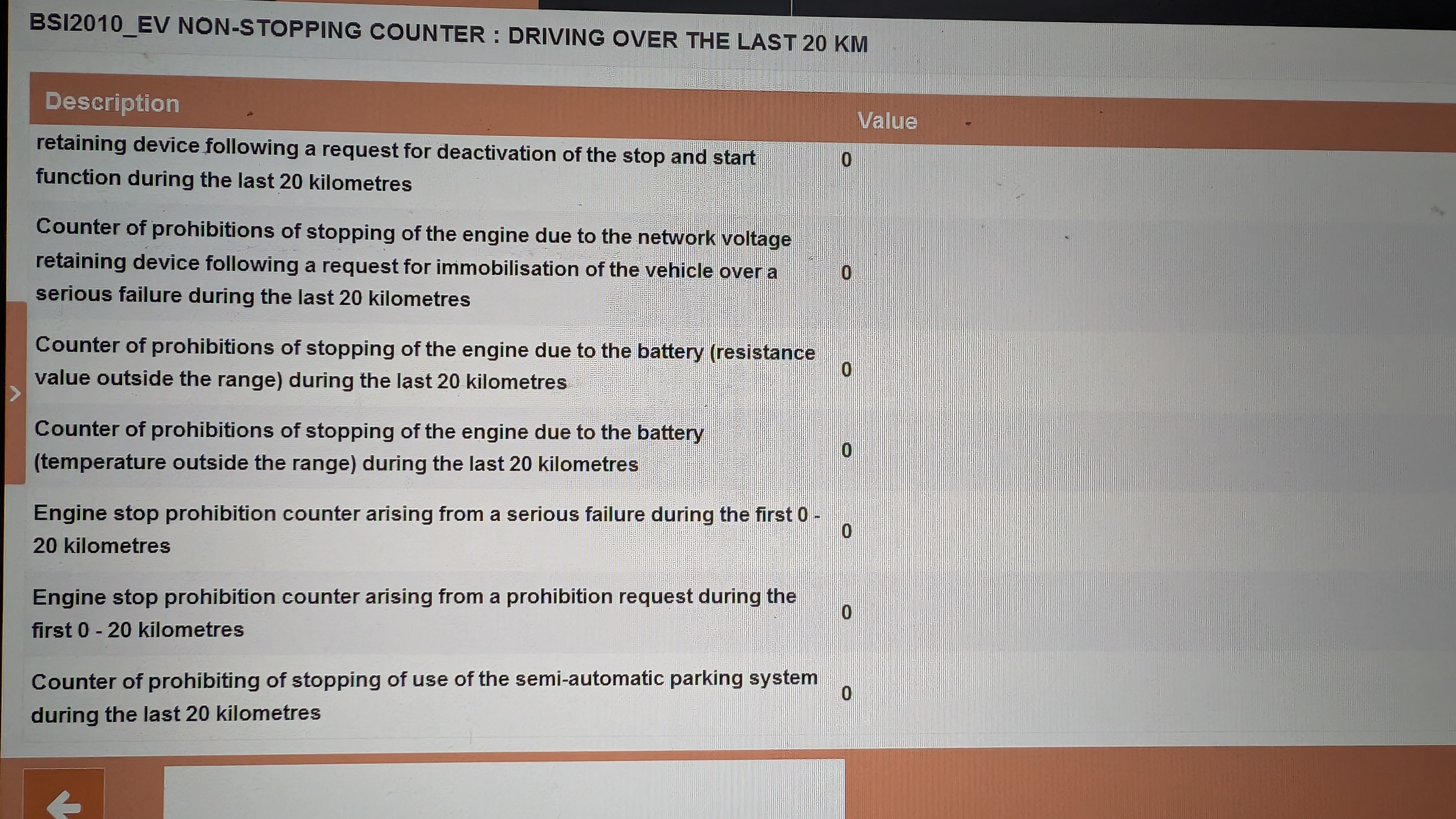

Additionally I found an option which lists you the reasons of why stop-start didn't engage during the last 20/40/60km but none of them show any reasons:
And here are just a few more options I found.

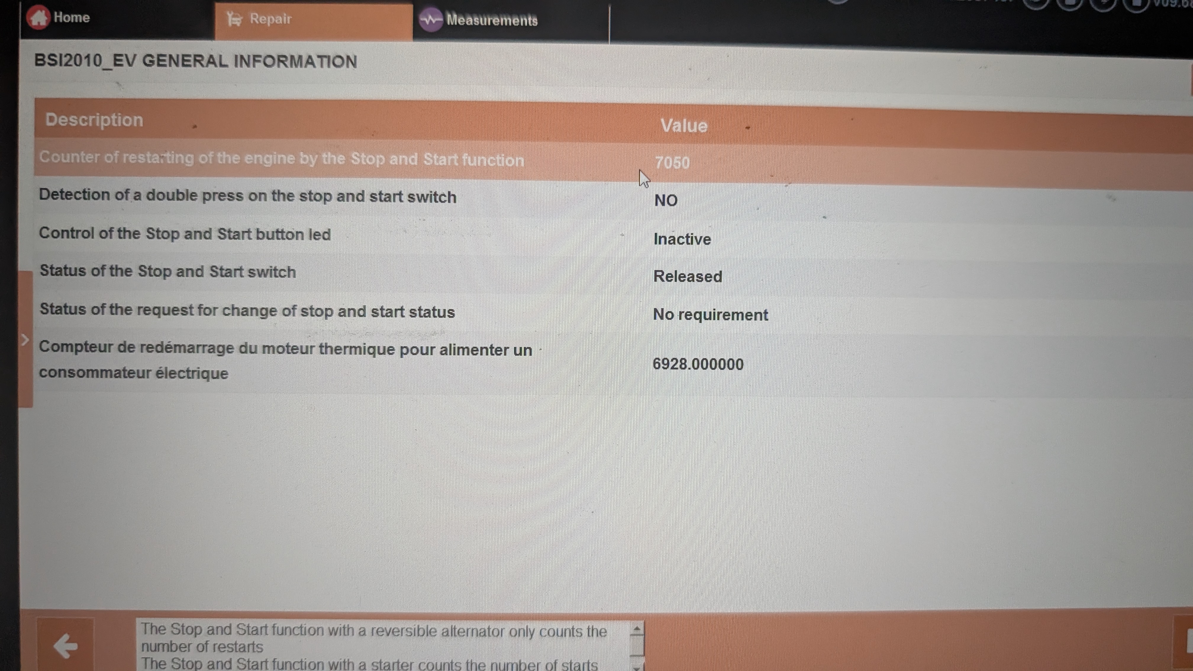

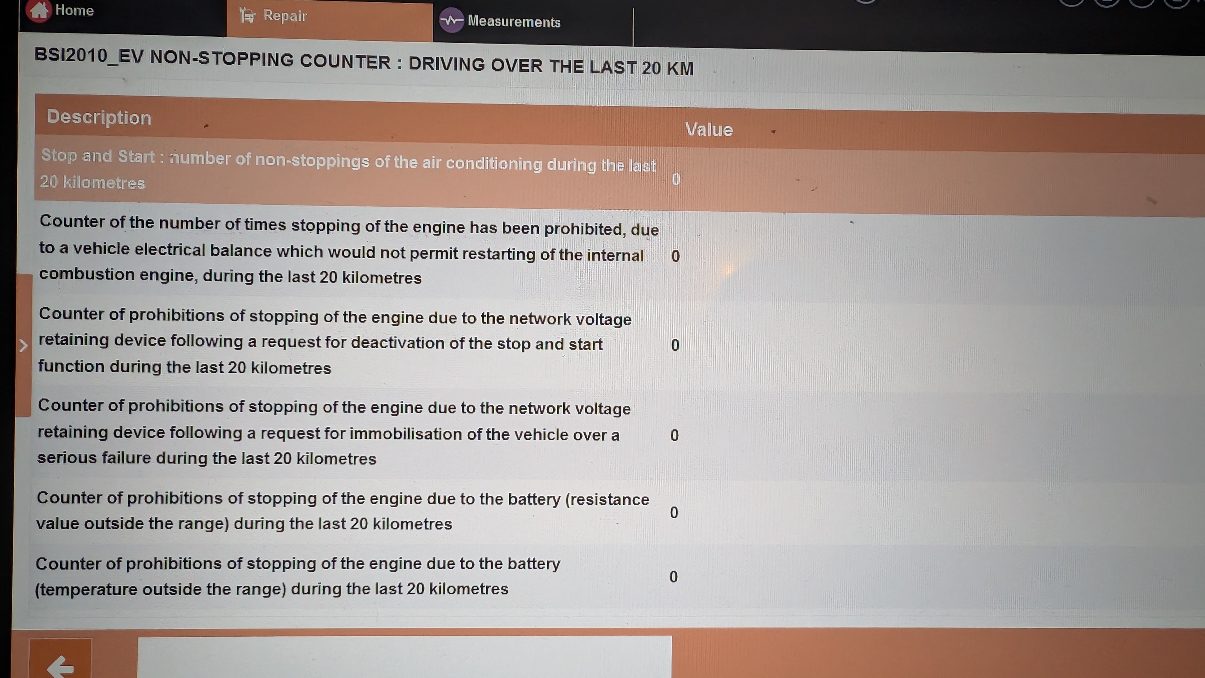

Yes, but if you look at the 10.13 V, on your screenshot, it tells you clearly it is ESTIMATED. This means that because it has not had the proper procedure done to calibrate it, it is being estimated - not actual. It's what I was trying to explain to you in my last post, about a new battery being charged, then installed and allowed to rest for 4 hours minimum, but preferably overnight, without any opening of the doors or switching on of equipment - otherwise you will wake up the networks and the calibration will fail.

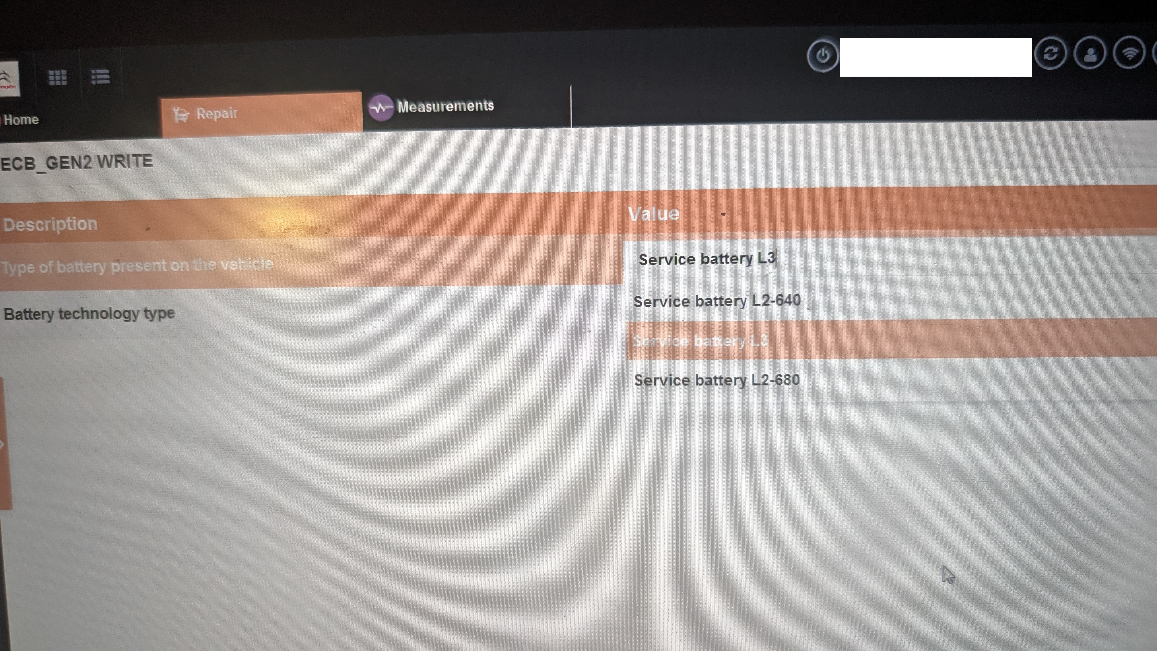

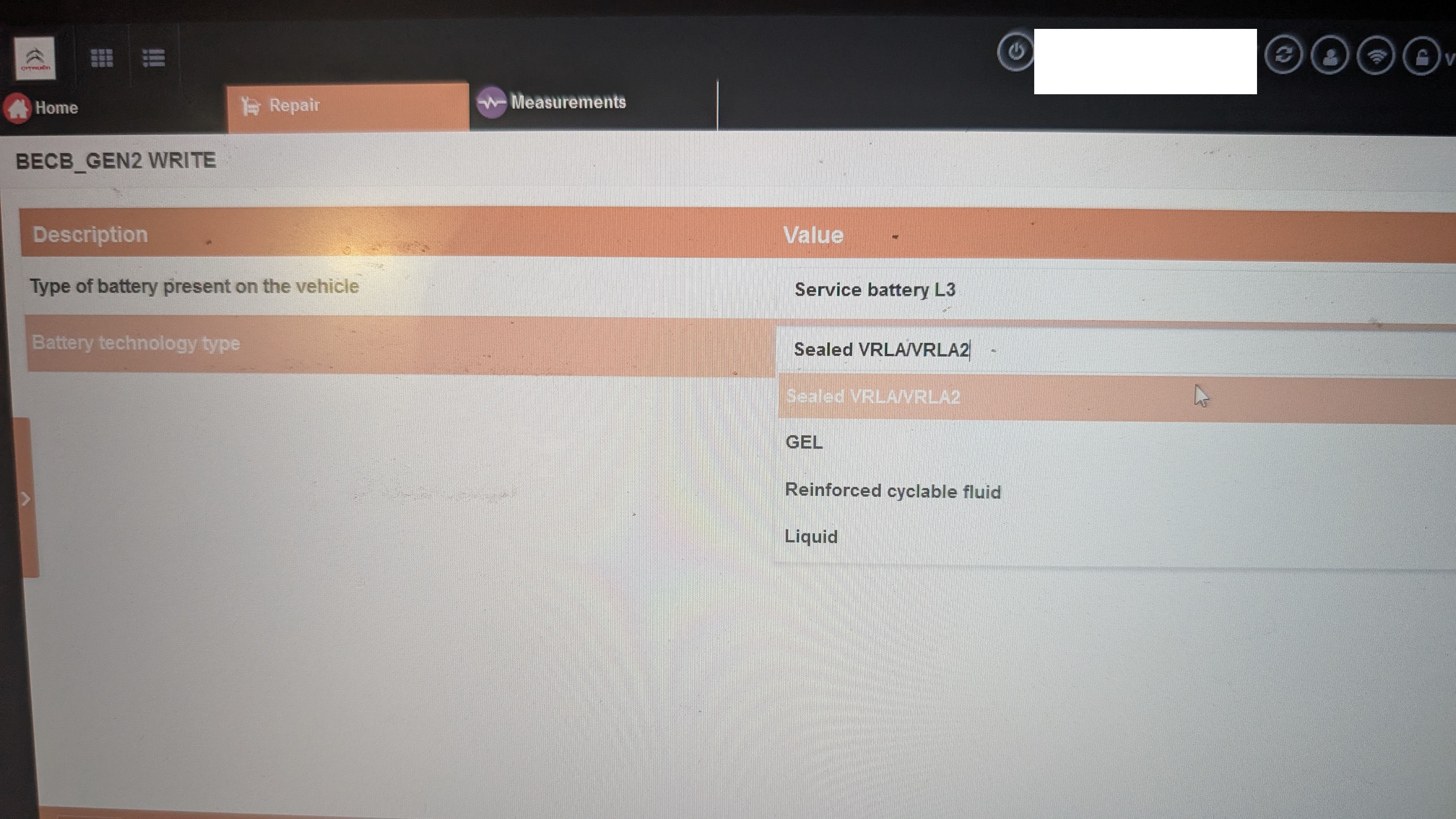

In the mean time I also figured out that installing an AGM battery is possible when switching the battery type from "reinforced cyclable fluid" to "Sealed VRLA/VRLA2".
For example Yuasa YBX9096 would fit well then.
The AGM battery should have the potential to be better but in my case it seems like the installed EFB battery is just healthy and fine as well.

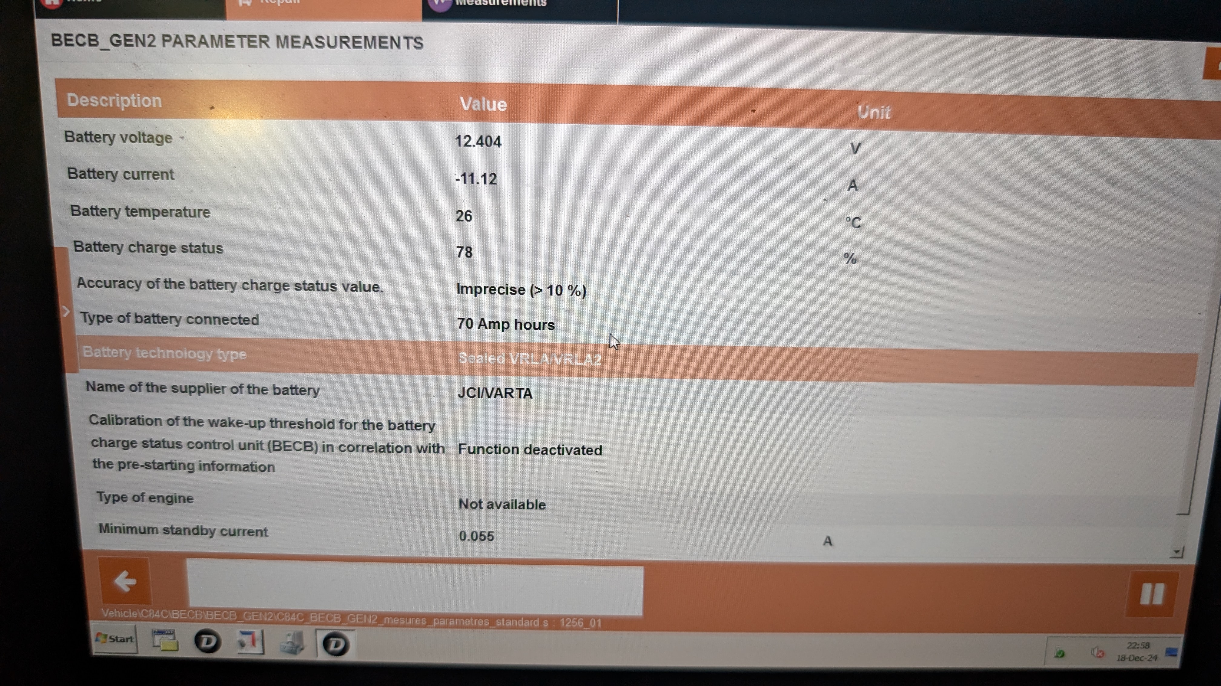

So I drove the car to get the battery charged. I disconnected the battery, waiting 15mins without the keyless dongle beating anywhere near, reconnected the battery and waited 14 hours.
I then drove for 1 hour and waited another 14 hours.
Then I made the following screenshots from diagbox.
The battery seems to be fine although the "estimated voltage on next engine restart" is still ridiculous low.
