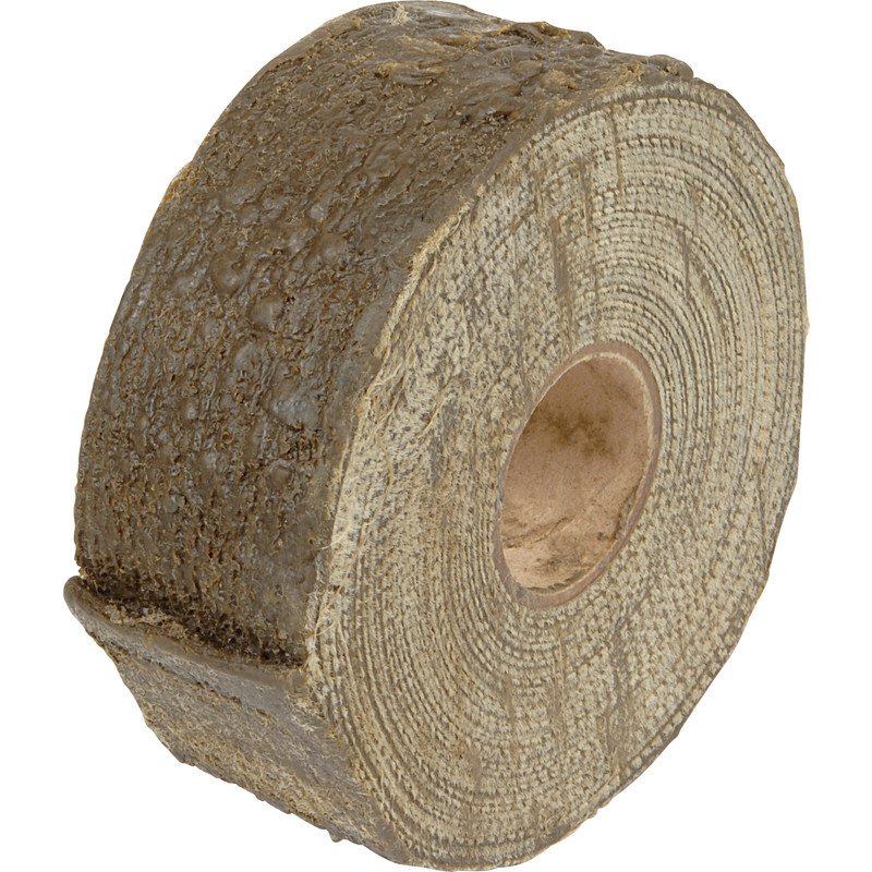

Now, as some of you might know, I am an engineer offshore, on oilrigs and boats, what very few of you will know is out there we use a product called denso tape, which is basically a fabric bandage impregnated with a brown wax oil type of stuff, making it very water repellent. We use it to protect cable glands, hydraulic fittings, flanges and bolts, lips on junction electrical boxes, etc. It is not a marine industry exclusive product, it can be had from Toolstation for about eight quid a roll:
https://www.toolstation.com/petro-tape-10m/p72819

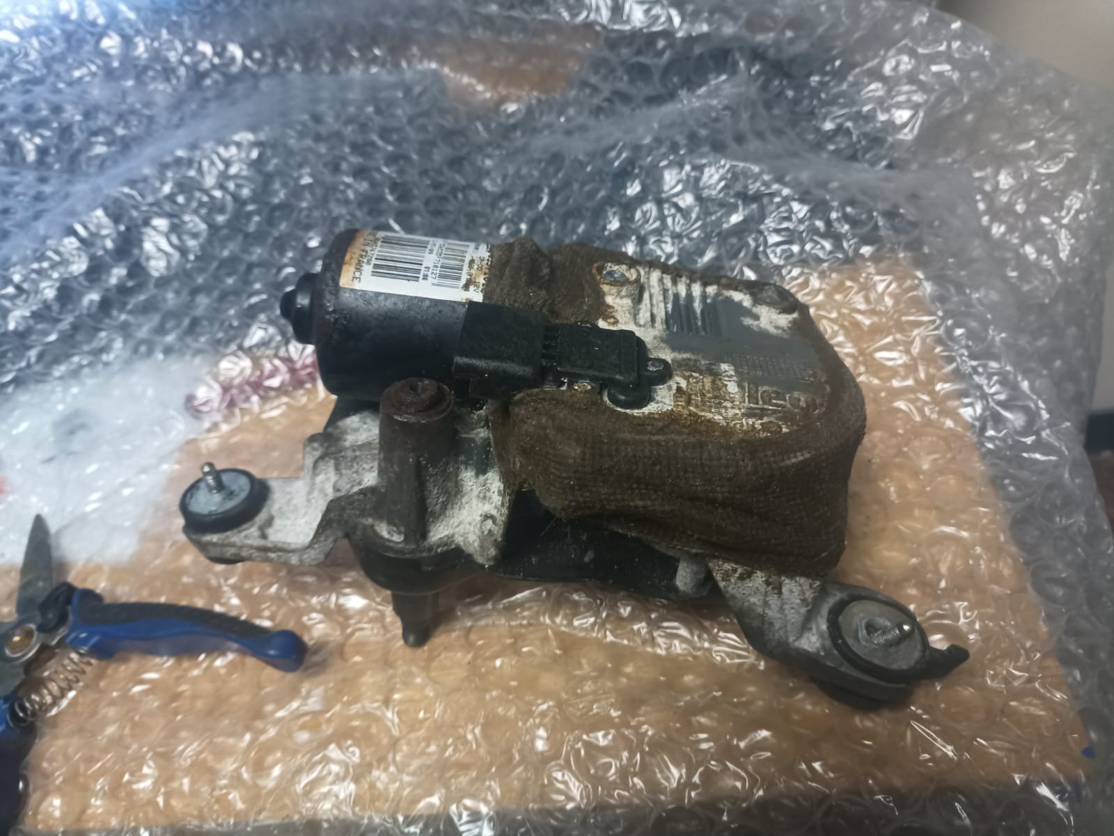

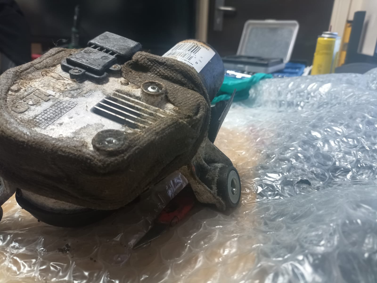

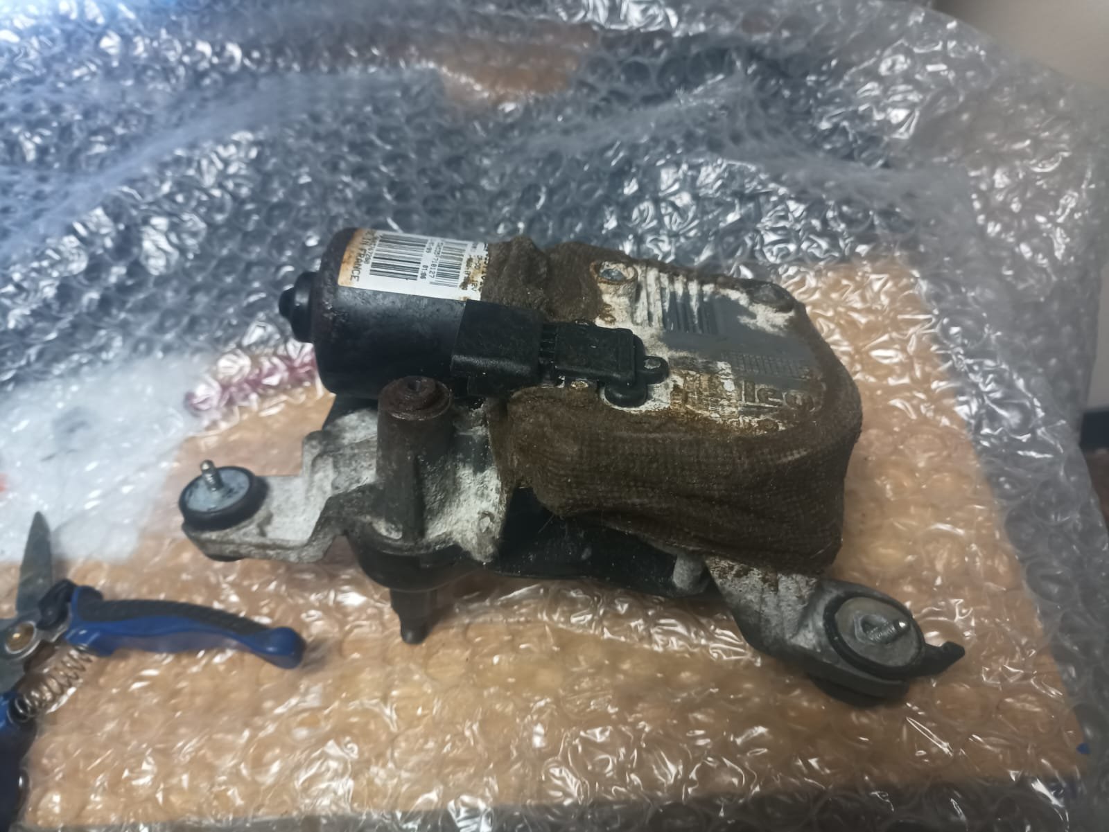

What I've done with it is applied it to the seam where the lid of the gearbox which the ecu is mounted to, joins the main body, as an additional barrier to water ingress:
To apply it, basically wrap a length of the tape around, and massage it in with your fingers, it is truly horrid stuff to work with, so I highly recommend the use of the thin disposable nitrile gloves when doing this.
I'd suggest others look at this seam, and apply some additional sealing there, whether it be denso tape, or a coating, or a smear of an adhesive, as the corner of the motor lid lies in the lowest point of the scuttle's drain path, so it will ALWAYS be wet. I strongly recommend this as it looks like wiper motors are a weak spot on these vehicles, and at £140 for a used motor, £360 for a new one, vs £8 preventative maintenance, it's a no-brainer to me.

This is a good idea, I went a similar route with mine but painted roof seal over the full thing leaving the drain hole clear. Also a film of silicone grease on the rubber gasket when reassembling.
