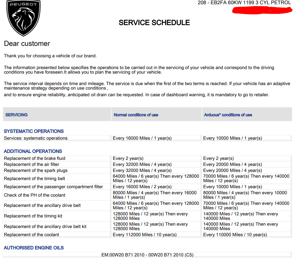

Hi all.
I own the above car. It's done 42262 miles and the dash is saying that maintenance is due.
Could anyone share the servicing and maintenance schedule for this particular model?
I plan on keeping the car so does anyone know of any issues or things to watch out for?
Cheers

That's great. Thank you very much.
