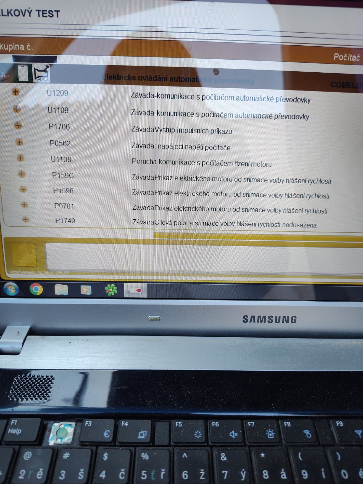

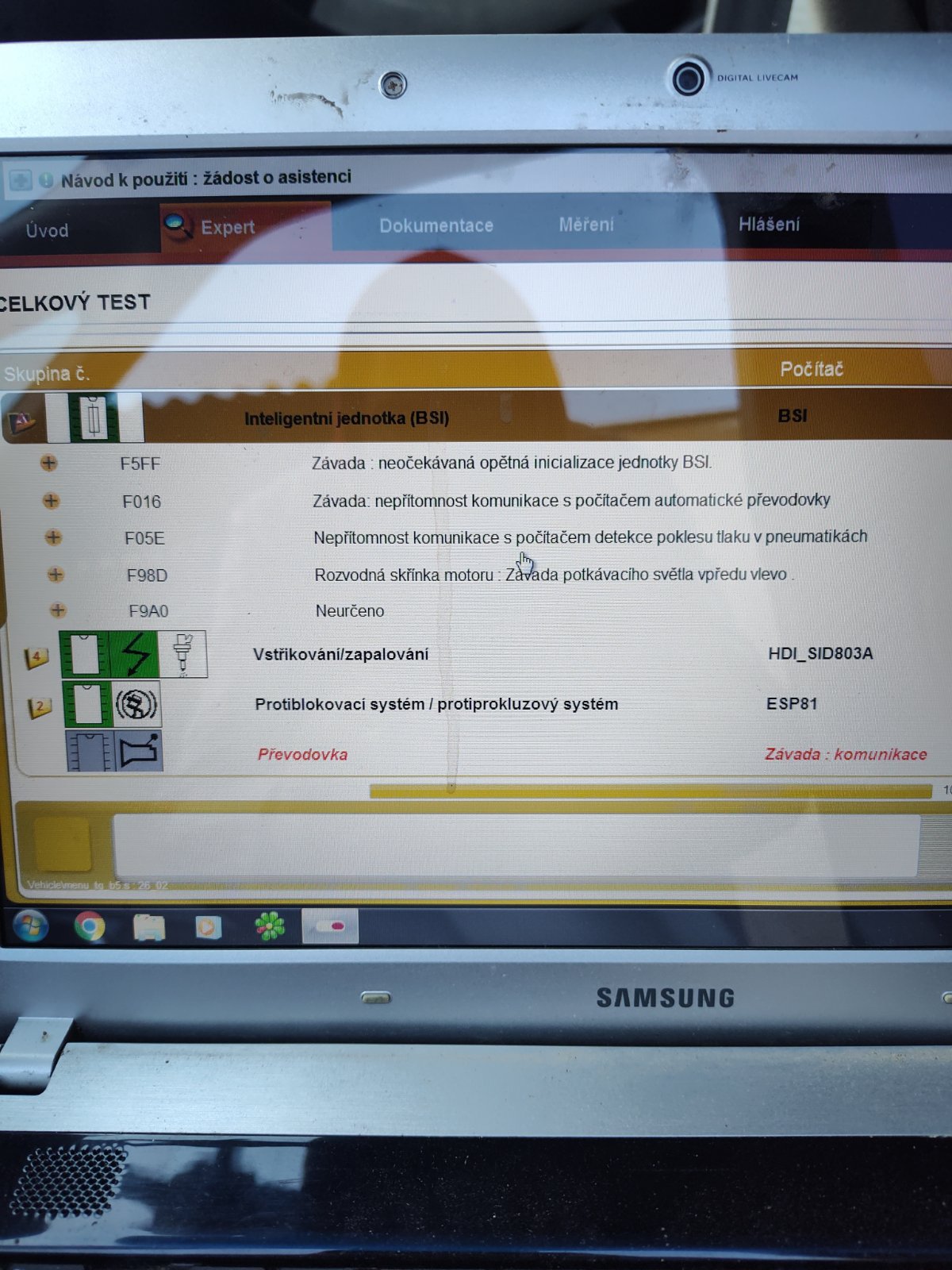

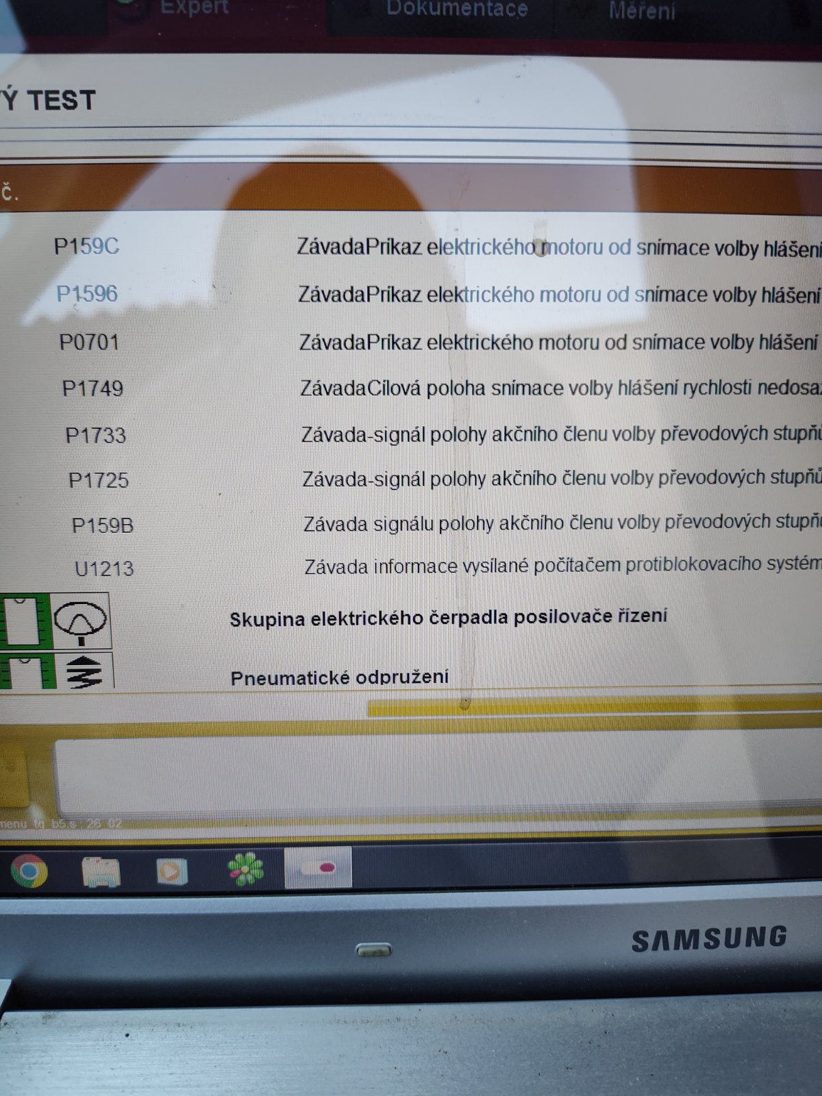

Hello, I have a problem with the car I just bought, c4gp 2009 2.0hdi full automatic. I give a print screen of diagnostics... The car only starts via the cable directly to the starter and then drives and shifts. But it doesn't show what is included. They are there. Just 2 dashes. The transmission light is on

Is it possible that you could find the actual Citroen DTC codes from your screen prints and post them up please? I am not sure many members speak Polish but it would help people if you can provide as much information in the forum's default language.
For example:- U1209
I found this on the forum - U1209 the communication between the gearbox ECU and the ESP ECU is missing
and there is a post which may or may not provide some insight for you:-
viewtopic.php?t=70795
So it would be useful for us to see all those codes translated. If you haven't already, it is worth clearing the fault codes and running a full scan again to we see only the actual current codes.

I doubt all those are current codes, quite probably a low battery at some time has caused them all to pop up. I would clear them all, and any in the engine ECU and ABS ECU, then see which ones come back and are permanent. If you have -- on the screen instead of speed, then quite possible there is an ABS sensor fault - without speed information the transmission will not know what is going on.
