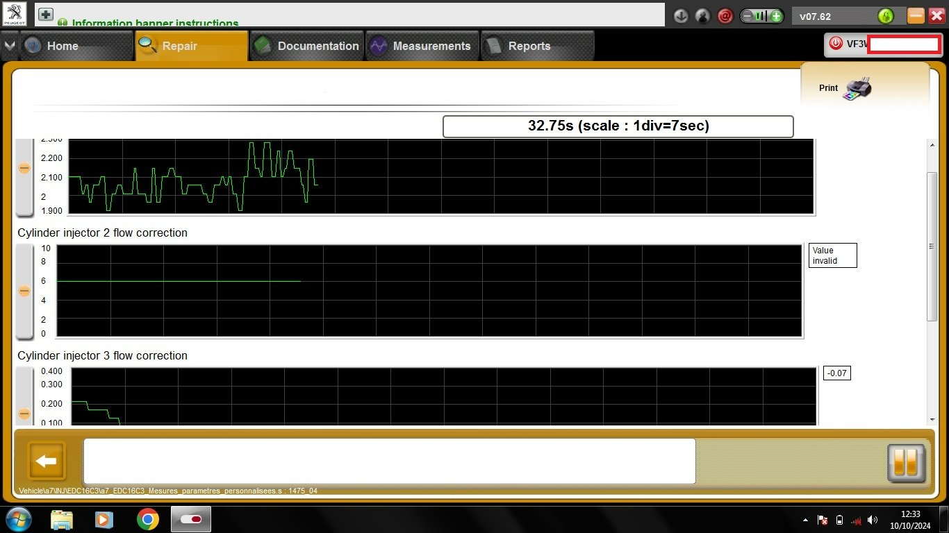

My 2008 Peugeot 207cc 1.6 HDi has a weird fueling issue so I thought I'd have a quick look with DiagBox to make sure the injectors are coded correctly.
While in there I did a live test on the four 'Injector Flow Correction' values.
Not too sure what I'm looking at but 3 of the injectors have what seem to be sensible values in the 0 to 2 range, but injector 2 is returning 'Value Invalid' and is flat lining at 6.
Does anybody have any idea what this means?
Invalid injector correction value

I'm guessing this means the ECU is pushing an extra 6mg per squirt into injector 2 (at idle!) which is then just coming straight back out of the low pressure return.

Now I've learned that the '6' is a reduction. So the ECU is almost shutting down injector 2 at idle as it's leaking so much back to the low pressure return (detected by a lowering of rail pressure maybe)

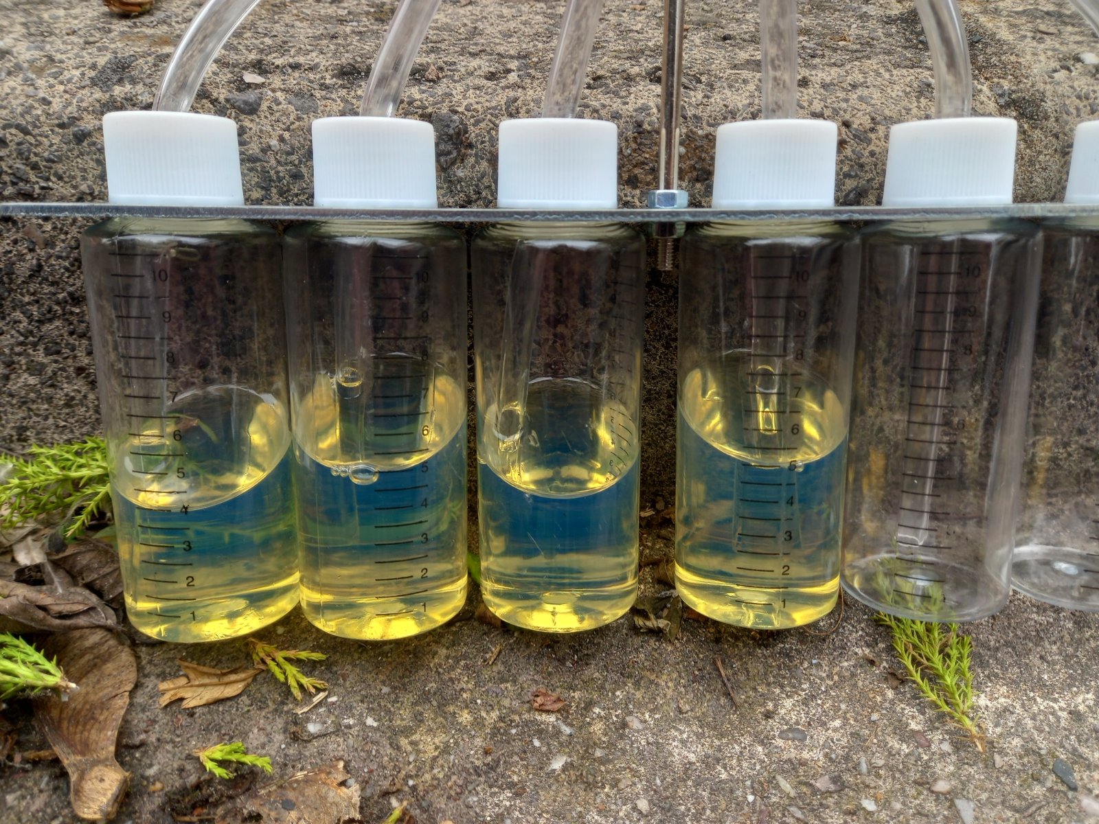

Re: Invalid injector correction value
Car has just returned an almost perfect leak back test. Urgh...
So why no smoke?
Only thing I can think of is that the heavy negative adjustment at idle is compensating for the a leak which goes away under pressure. So... leaking pilot jet?

Sorry to necrothread, but I said I'd keep people updated.
Finally took it for a run with Diagbox running.
Seems our +6mg (if that IS what it means) injector tails off to normal at mid-range load, but then starts to head the other way.
When it hits the -6mg limit, (at high load/rpm), the fuel pressure flatlines at 1250 bar so I suspect that's the limiting factor.
Ultimately injector 2 (and being PSA, that's the second injector from the GEARBOX end) is knackered. But it works in mid-range and the ECU is compensating at idle.
