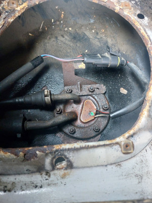

Is there even a lift pump fitted to this?
I wouldn’t have thought so, how many terminals are there on the sender unit? Note there may be 4 wires on the plug that connects to the sender but check how many terminals are actually on the sender unit.

There are 3 wires goig to the sender unit

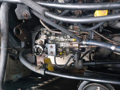

The engine is the 2.5 non turbo engine but not sure which injection pump is fitted,

3 wires to the sender is only enough for the gauge and warning light, so there is no in-tank pump.
There were versions with Citroen or Fiat engines. Maybe if you post photographs of the engine and pump, we can recognise what you are dealing with.

I have taken some pictures, but can't see how to put the attachment onto the message?

Whats the history? Was it running ok the last time it was started then would just not start? Or did it cut out whilst driving?
Will it fire with a burst of easy start?
If you slacken the injector pipes do you get fuel at the injectors? Tried pumping the hand primer?

Re: Fuel cut off switch
The engine hasn't run while I have had it, it was bought as a project but was said engine and gearbox are good. 3 of the injecors were out and the fortth was so tight I didn't want to snap it. I have had the three injecors test and they were all fine. The engine is on the verge of starting but won't start. I have slacken te injecors off while a mate pumped the manual pump and had fuel coming out at each injjector. We then tightened them up again and tried to start it up using easy start while pumping fuel with the manual pump.This time it was just the same in that it was on the verge of starting but just not quite there.
