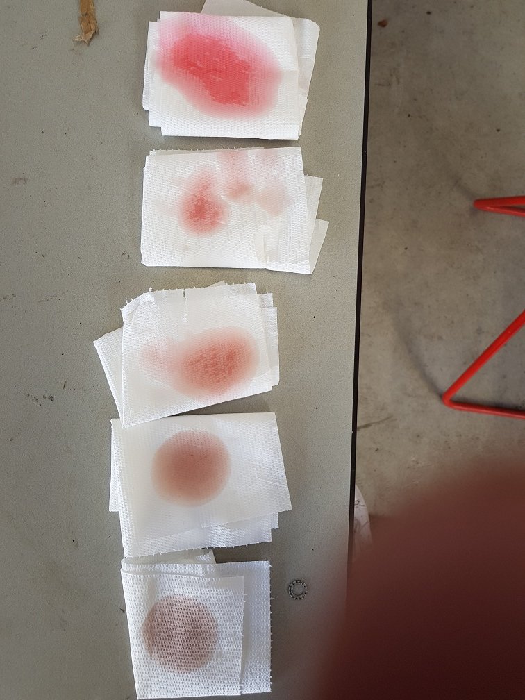

Here you can see the difference between the old and fresh oil change.
I did this a month ago, and my car was around 200000 Km.
I followed the video of the Volvo car.
Greetings,
