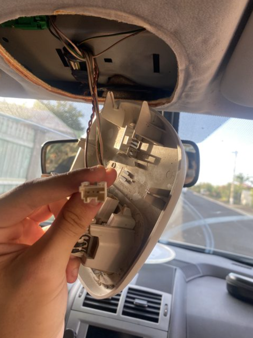

also, is this the end of the black plug in the quadlock? I reckon thats a microphone slot right?

There's 2 pins to the mic, earth and positive, but there should be codes on the sleeves
8487 (+)
8488 (Earth)

Re: 407 RD4->RD45
Unread post by robertel99 »
GiveMeABreak wrote: 20 Aug 2024, 18:13 There's 2 pins to the mic, earth and positive, but there should be codes on the sleeves
8487 (+)
8488 (Earth)
got it, thanks again you re the best
