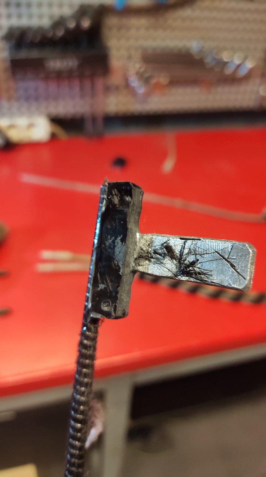

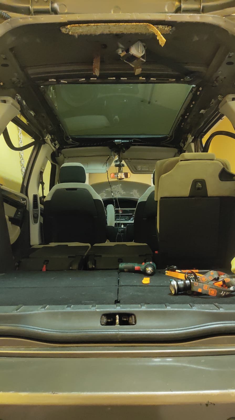

I decided to fix the panaromic roof myself. There is no a good guide about this fix but I've taken lots of picture and video for guidence to others.
This is second day and I thought this job was ending but it crashed again and break the tubes.
How should I adapt the button? He probably doesn't know where the curtain is.
Before the break I tried to press the button for 10 second but no go.
I have a diagbox 9.xx that I have never used if that helps.
cb
btw I have used 'forged' carbon fiber + aluminum for the rail part (I've used what I have)
