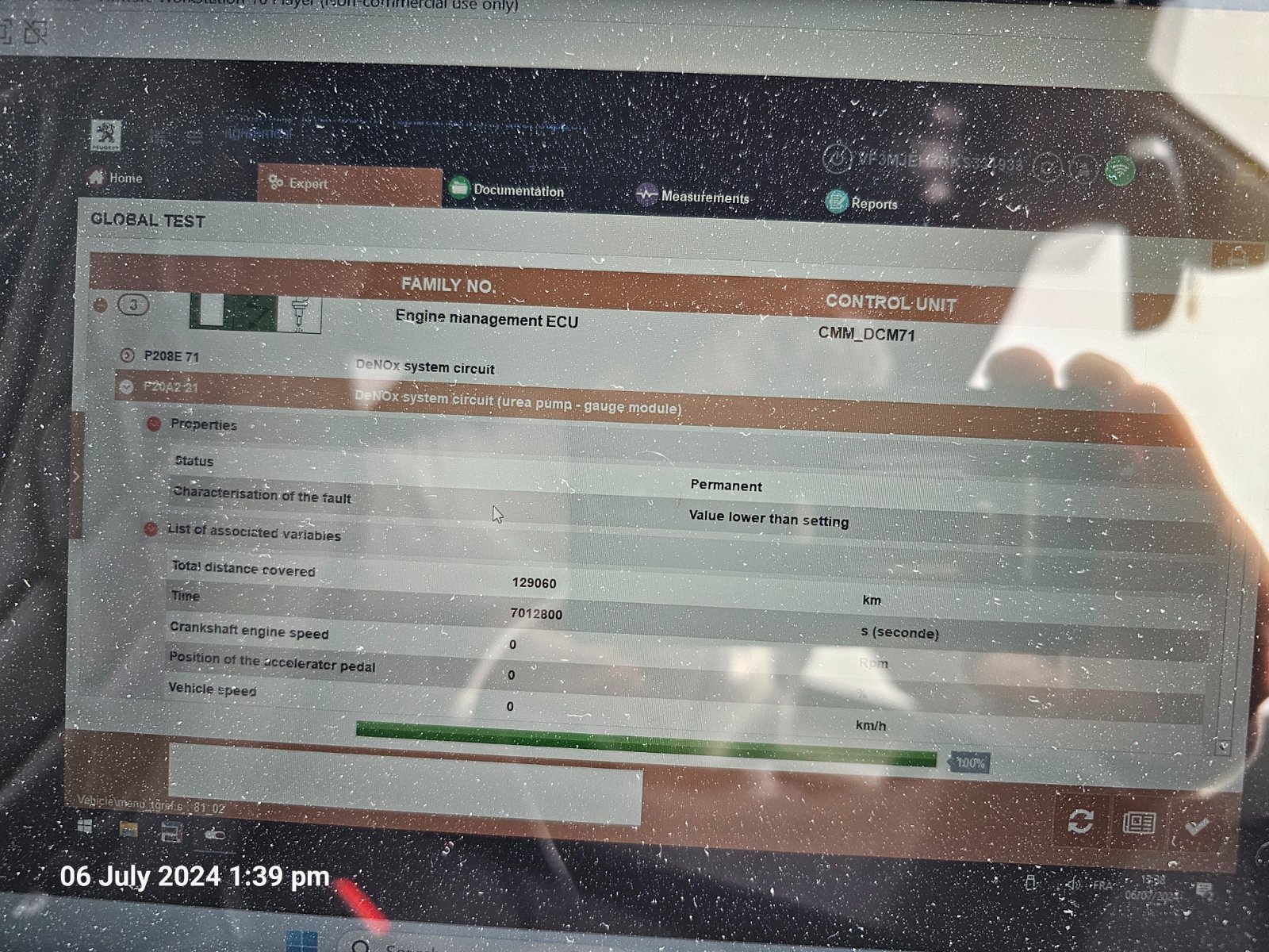

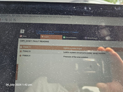

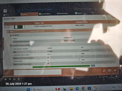

I had warning message on the dashboard "engine fault" together with "adblue" light. On Diagbox I can se 3 faults- P208E 71, P20A2 21, P20E8 21.
1st one refers to jammed injector ( see attached pictures) and the other 2 to pressure of the system. I deleted them, went for a spin and all good , no warning messages. Connected it again to Diagbox and I saw P20A2 21 and P20E8 21 faults again. I assume that first fault triggers the warning light on dashboard. I ran an actuator test and tested the injector, pump and pressure and all shows no issues. I can even hear the noise of the pump and injector. I read on the forums that injector can be clean or changed relevantly easy buy have no idea how to proceed with the other 2 faults regarding the pressure. Some people advice to start with changing the tank cap.

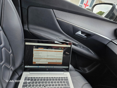

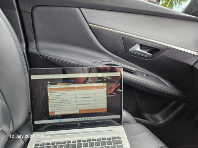

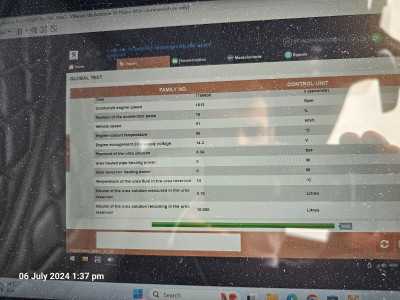

I ordered a new injection and changed it. Drove it for a few days and there was no warning lights on the dashboard. Yesterday I contacted Diagbox and saw that the faults were gone by themselves. Also went for a spin with live data on Diagbox. The pressure of the additive was 5.8bars and when the injector operate it dropped to 5.1 bar( see attached photos). Is that the correct pressure of the system? I suppose in that case that pump is not dead.

That pressure seems about right. It was likely the UREA injector was blocked. Keep using the Wynne's regularly when you top up and hopefully it will work its way round and help prevent further issues.
