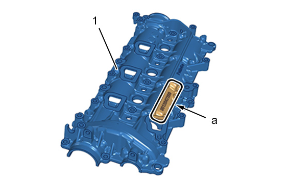

Check if there is a knocking noise in the upper area of the cylinder head on the timing belt side.
If there is a noise: Continue the check.
Identify the type of camshaft drive chain fitted to the internal combustion engine.
Locate and note the part number engraved on the camshaft carrier (1) (at "a") using a mirror .
If the part number is 9812647280: The internal combustion engine is fitted with a 7 mm camshaft drive chain: Carry out repair .
If the part number is 9830580480: The internal combustion engine is fitted with a 8 mm camshaft drive chain: The internal combustion engine has been modernised: Do not apply this document; Carry out in-depth fault finding.
N.B. : If the camshaft drive chain is noisy and the internal combustion engine is fitted with an 8 mm camshaft drive chain, send a dealer issue detection incident (DID I)
