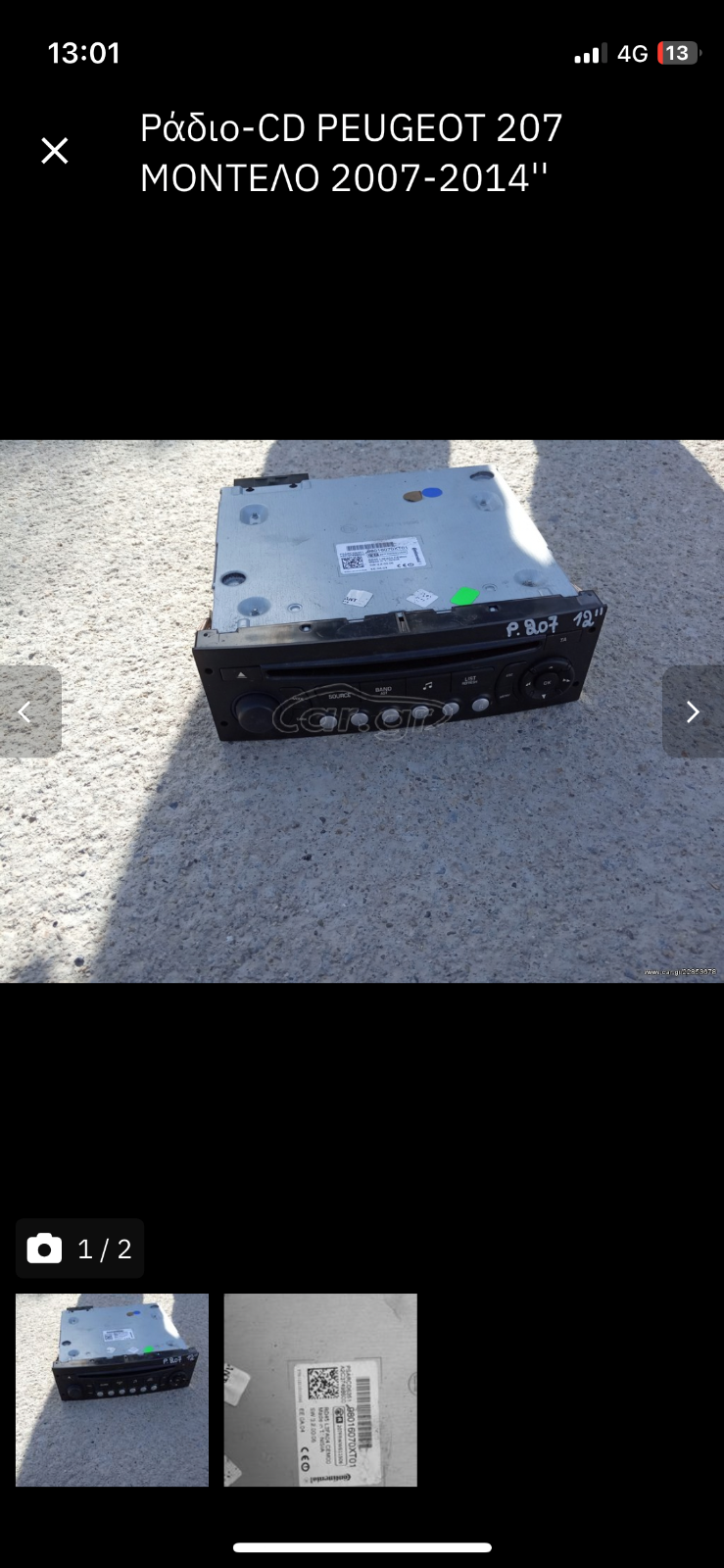

This is the radio I was planning to buy can you tell if it need a microphone or anything else?
x 6957
Re: Citroen c4 2008 display
See my last post ^
