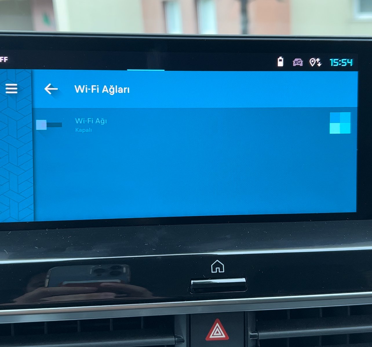

I own a C4X 1.2 130HP 2022. My problem is car Wi-Fi is not working and I can not check updates or use connected services. My dealer says they have no idea about the issue but I believe that it is not a hardware issue but software.
Is it somehow possible to activate Wi-Fi connection?
There is a Wi-Fi section in the settings but when I try to activate it it is not responding and can not activate Wi-Fi

You'll need to provide your VIN so I can see what your car has, but from the picture above, it does not look like you have switched it on - the bottom shows a slide and that needs to be switched on for WiFi

When I touch the switch-on slide goes to middle and there is an animation starts on the upper right but 1 minute later it goes off again and nothing happens. Wi-Fi is never on.

Ok, so your vehicle is not fitted with on-board WiFi, which is why you can't activate it.
In this case, you will have to tether you smart phone that has WiFi to the car. Once you have shared WiFi access from your phone to the vehicle, the car can then use your Smartphone's data connection for certain features.
