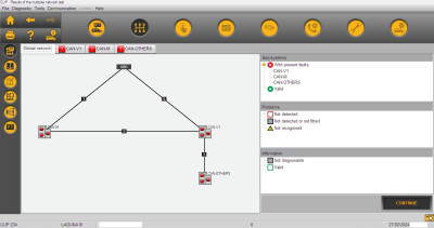

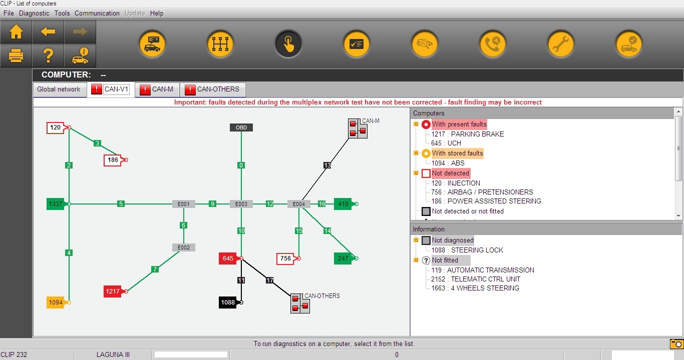

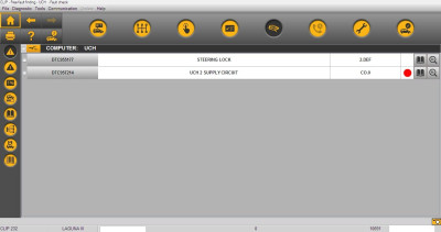

Here are the screen shots of the scans of Renault Laguna 3, please see attached

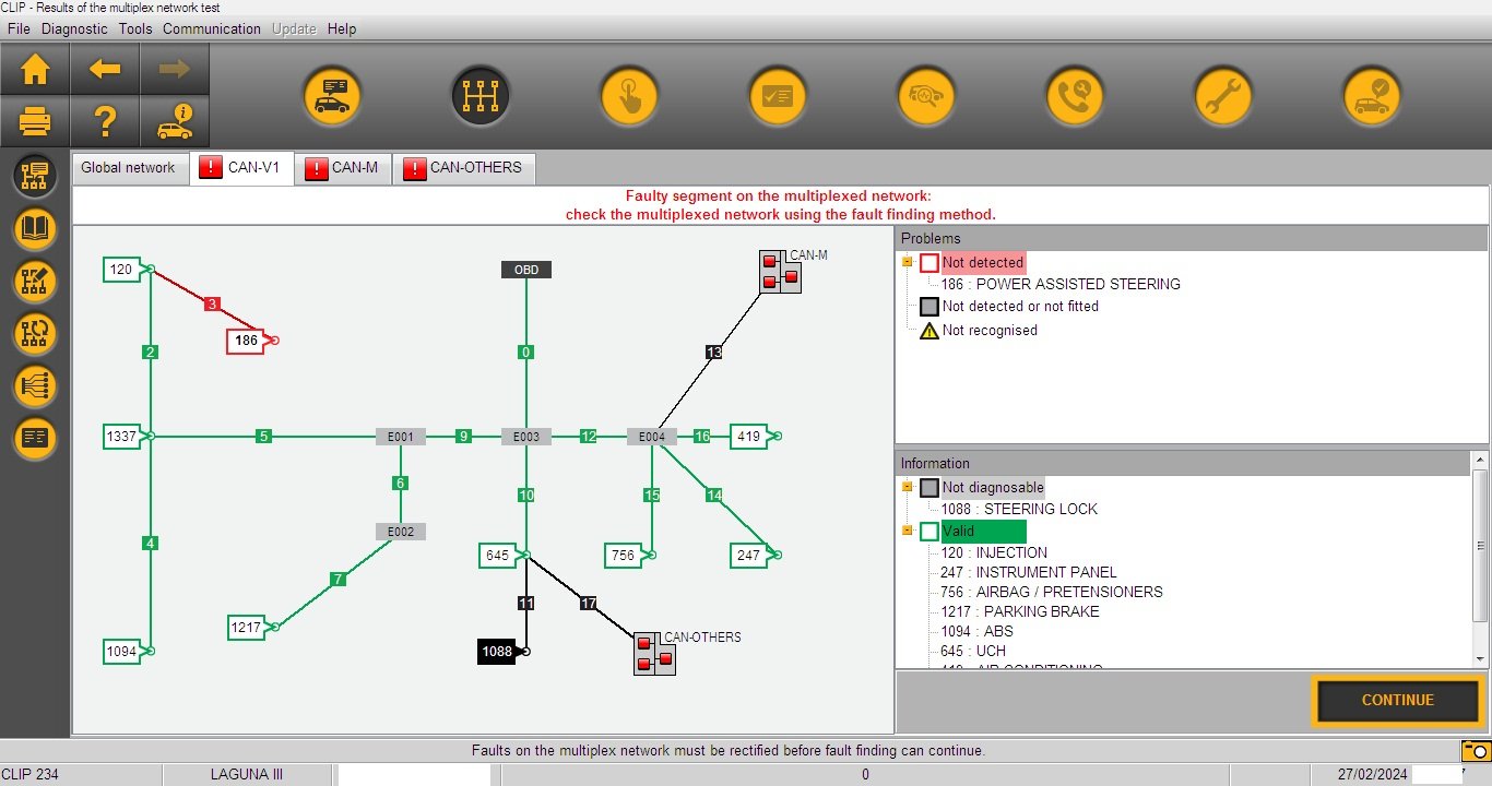

CAN-V1: 186 Power Assisted Steering

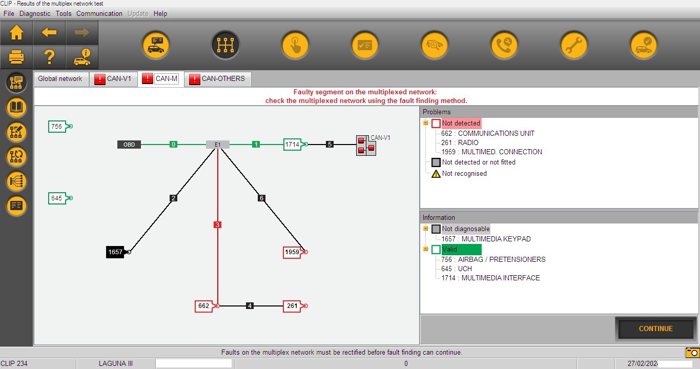

CAN-M: 662, 261, 1959 (not sure what this means? )
CAN-OTHERS: 1222 (something to do with parking proxy can??? )
Also what does the other messages mean?
"Fault on the Multiplex... "???
"Faulty segment on the multiplex network"???
I have limited knowledge on how to use this CAN-CLIP so i am a novice
Any Help and Advise i would be Grateful so many thanks for your help in advance

I MANAGED TO GET SOME MORE INFO OF THE PROBLEM
DTC517577
DTC516F68 -------------
DTC516868
DTC50CB14
thanks for any help provided

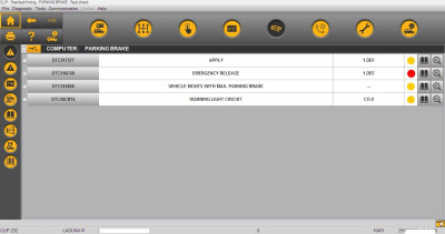

I cleared the yellow codes but only 1 red code still remains
Computer: Parking Brake
DTC 516F68 Emergency release 1.5def
The (p) on the dash keeps flashing then goes off does not appear again and the brake button light behind the gears stick keeps flashing red
PARKING BRAKE

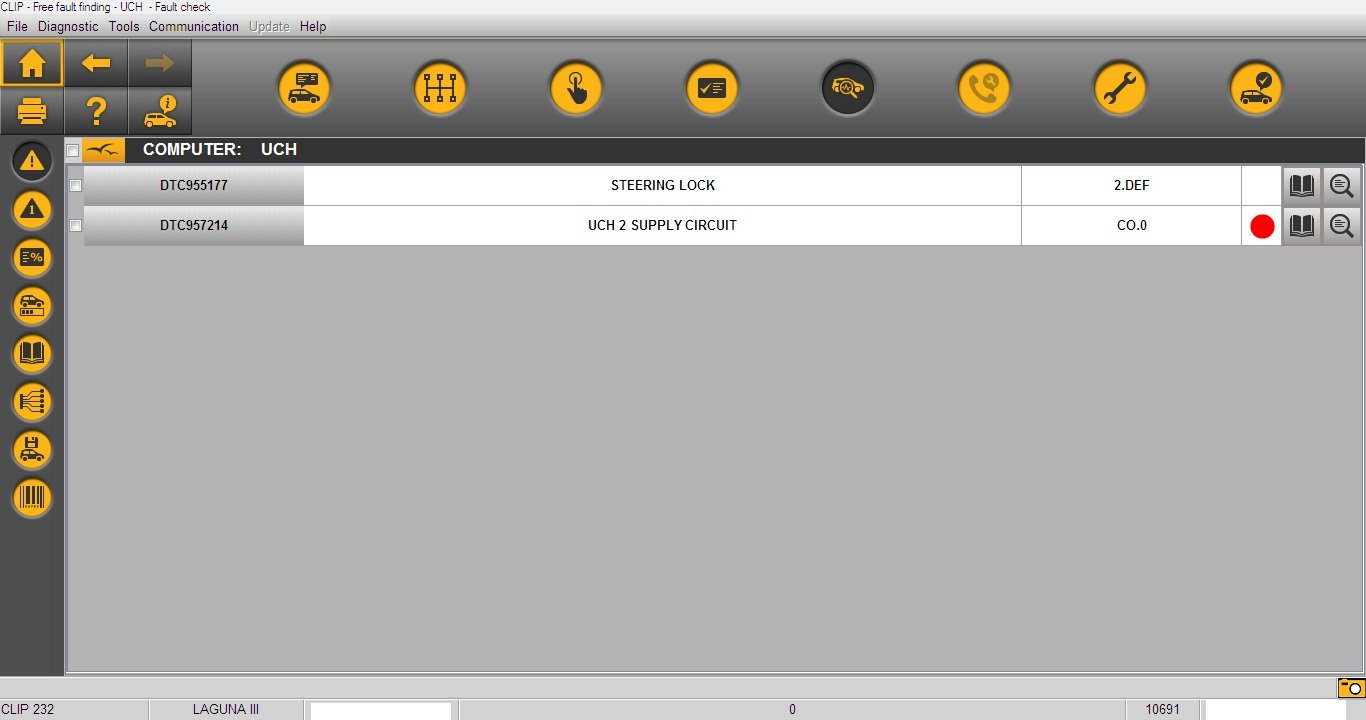

UCH
Index
Title
Characterisation State
DTC957214 UCH 2 SUPPLY CIRCUIT CO.0
PRESENT
Context when fault appeared
Index Title Value
Additional data
Index
Value
MILEAGE SINCE LAST APPEARANCE OF FAULT
Index
Title
CharacterisationState
DTC955177 STEERING LOCK 2.DEF
SAVED

PARKING BRAKE
Index
Title
DTC50CB14 WARNING LIGHT CIRCUIT CO.0
Index
Title
SAVED
DTC517577 APPLY 1.DEF SAVED
Index CharacterisationState
Title
DTC516F68 EMERGENCY RELEASE 1.DEF
PRESENT

UCH
Index
Title
Index
Title
PRESENT
SAVED

SAVED
UCH
Index
Title
Index
Title
PRESENT
SAVED
ESP
Index
Title
DTC407481 EFFECTIVE MEAN TORQUE MULTIPLEXED INFORMATION ---
SAVED
