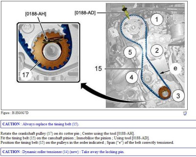

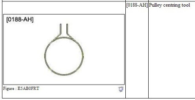

Re: P0341 after timing belt change
Unless the cam sensor has been physically damaged in each of these timing belt changes above this surely has to be the belt hasn't been done properly?
Even if you pin the crank at the flywheel the pulley still has a little bit of 'float' each way & is meant to be centralised with a tool like this, its like the keyway is slightly elongated.
Id guess that when the engine has been rotated the pulley has not been centred with a tool like this. If this is the case the timing will be very slightly out (less than a tooth) not enough to do mechanical damage but enough for it to be picked up by the camshaft sensor.
