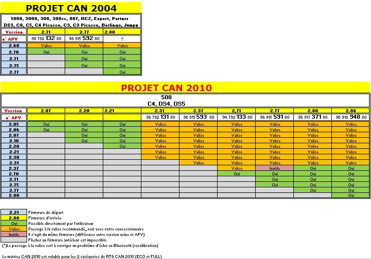

Hi im searching for the 2.85 Version du Update my currently FW 2.21. Ive read that Updating from lower Version directly to 2.86 can cause Problems.
Best Regards
Dom
OnlinePaul-R
- Posts: 9010
- x 1873
Re: RT6 firmware

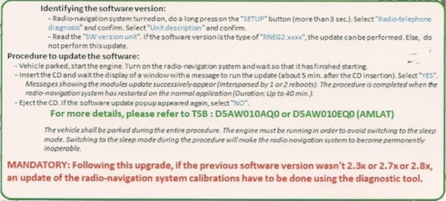

According to the attached charts updating from 2.21 to any later version will mean losing your configuration settings. This will need either paying a dealer so that they can download the configuration files from the Stellantis servers or using Diagbox to change individual settings. You should be able to use Mirascripts to download the configuration file before you update and then apply it after updating. I strongly suggest that you do this.
Check your PM for a link in five minutes.

If you look at the tables ten posts above this you can see that updating from 2.1 (actually 2.10) is only advised to 2.21 to be good. Any higher version will need a Diagbox session which means going to a Citroen dealer so they can connect to the servers in Paris to download the configuration file for your vehicle. They will charge for this service.
You should be able to use the Mirascripts program to download the current configuration from your vehicle before you go to the higher updates and then upload this configuration to new firmware. This should work although a post above says that they had failure doing this. Mirascripts can also change your configuration (for volume, Bluetooth echo, etc) although I have never done this.
Check your PM for a link to download 2.21. This is a version to load onto a USB stick. Usual disclaimers, use this at your own risk, etc.
Use Mirascripts to download your configuration first just in case of an unforeseen problem. Let us know if this works for you and then, if necessary, I can provide links to later firmware versions.
