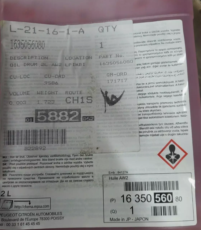

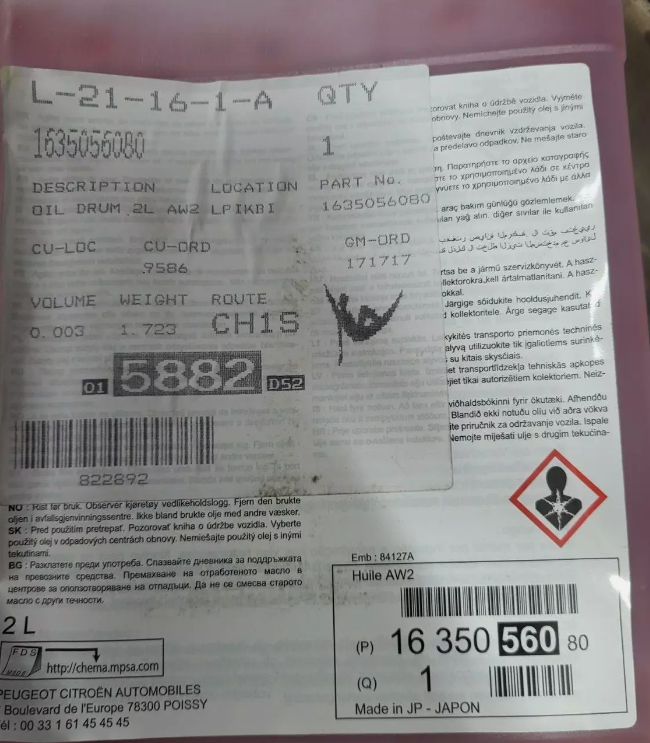

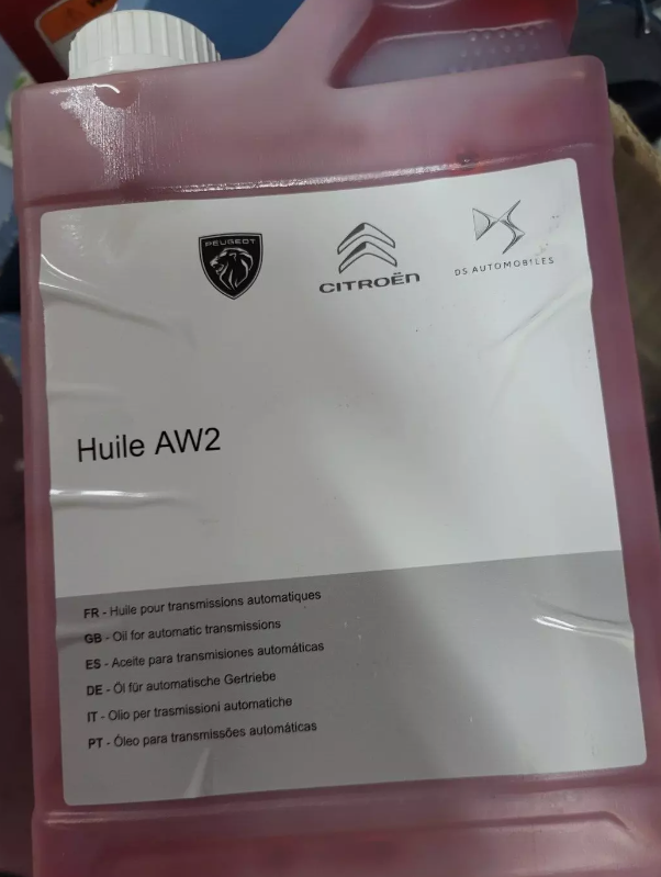

No, you musn't use any standard transmission oil. For this gearbox you need specifically AW2 Oil:
