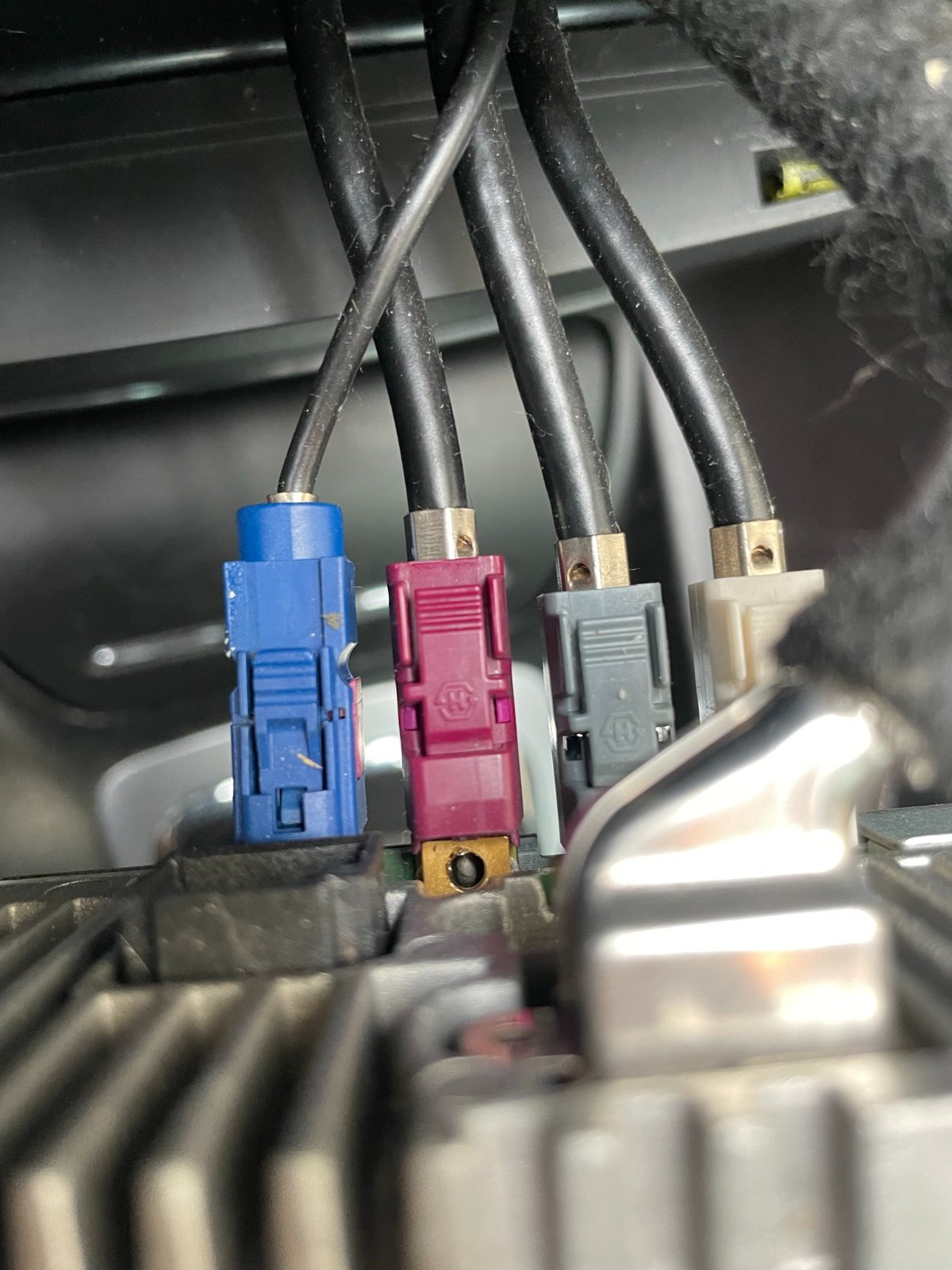

Just removed the head unit and noticed that this purple connector is not in line with other two on the right. It's not loose (all other connectors are solid too), but it won't go all the way down like the others. Might this be a problem?
x 6958
Re: '09 C5 stereo question
No it's the GSM aerial - as long as it is in its socket, just leave it.
