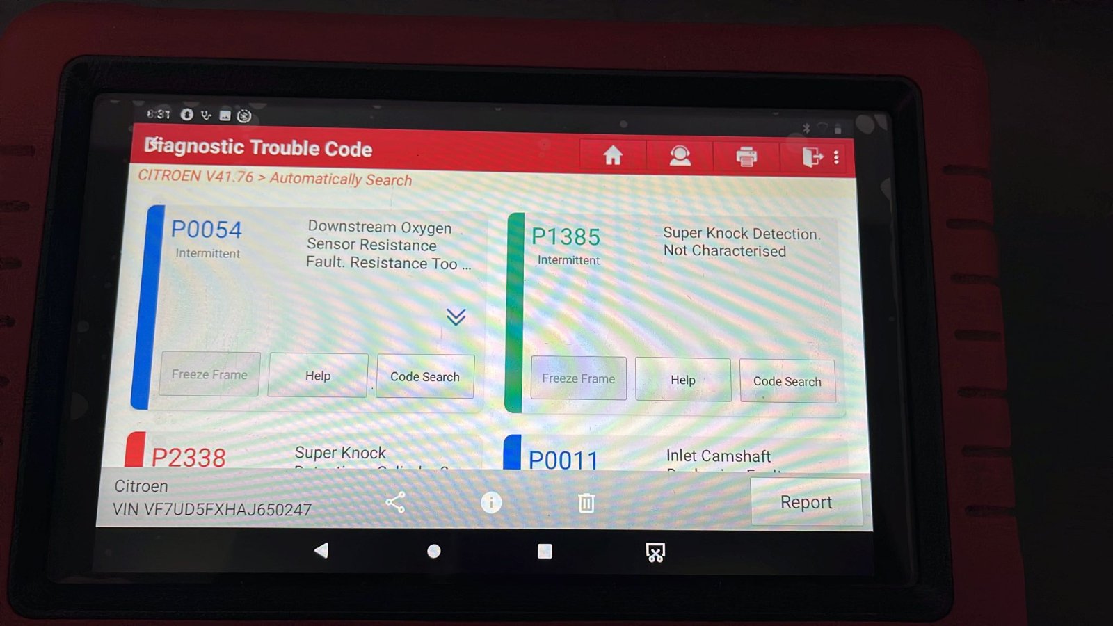

BUT, i got from the service guy the picture with the following errors. He says he only found 1 L of oil as a week ago we changed the gasket on the oil pan and filled up with necessary oil after. More precisely, the car lost about 3 litres of oil in 7-800 km done in mixed mode, city + highway.
My next question was "But isn't there an oil sensor on the car to warn me about the low volume?" The answer was simple: "NO", C4 Picasso 2010 does not have oil sensor, the error pops when the level is critical, and when you see the warning you should immediately stop, check the oil level and fill it on the spot. Is this true?
His next thought was segmenting the engine. What should i check for now?
These is a photo with the errors:

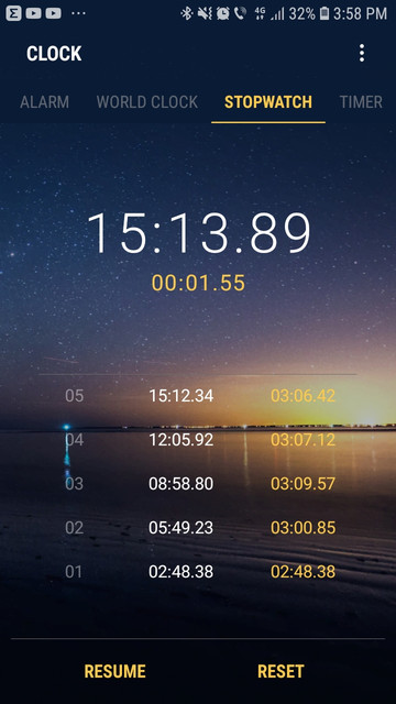

New update, alternator working, battery in good shape this means what? In my opinion is a software problem that needs to be coded or there is too much work to be done, check every wire and connection until you find the spot?
I just have a thing that bothers my sleep every night with weird questions. What can cause a battery error at ~3 minutes after the engine starts? Is there a status check (error check) on the car computer 3 minutes after i switch the key? This is happening every time, no matter how many electrical consumers i use, even if the car is just started or running on the highway. The error is there after ~3 minutes. If i stop the car i can make it another 3 minutes round, and so on. Did some stops and the 3 minute problem got me, what was i thinking when i bought a 13 year old car with a piloted manual gearbox? But as i trend to be a techy guy i want to know the cause and effect, so anyone faced something similar?
Should a Lexia diagnosis clear my mind and let me sleep with a clear explanation? I am asking you this because i have to drive ~150km to the nearest dedicated Citroen service.
So let's review, car starts great and drives great for 3 minutes, after that the only change i have seen is the AC that stops cold air (i assume that when the error pops the computer shuts down the big consumer guys). So no radio stops or sound, no display stops, no headlights dimmed, no other errors, i can play with the panorama button just like no problem was there, just like a normal car but without cold air blowing, just air, and as far as days are getting hotter all i can get is hot air
As you can see below this is a screenshot of every restart of the car, it takes ~3 minutes to get the error on dashboard (1st timing i just forgot to tap phone

You did not mention whether you diagnosed the (apparently) non functional turbo cooling pump.
