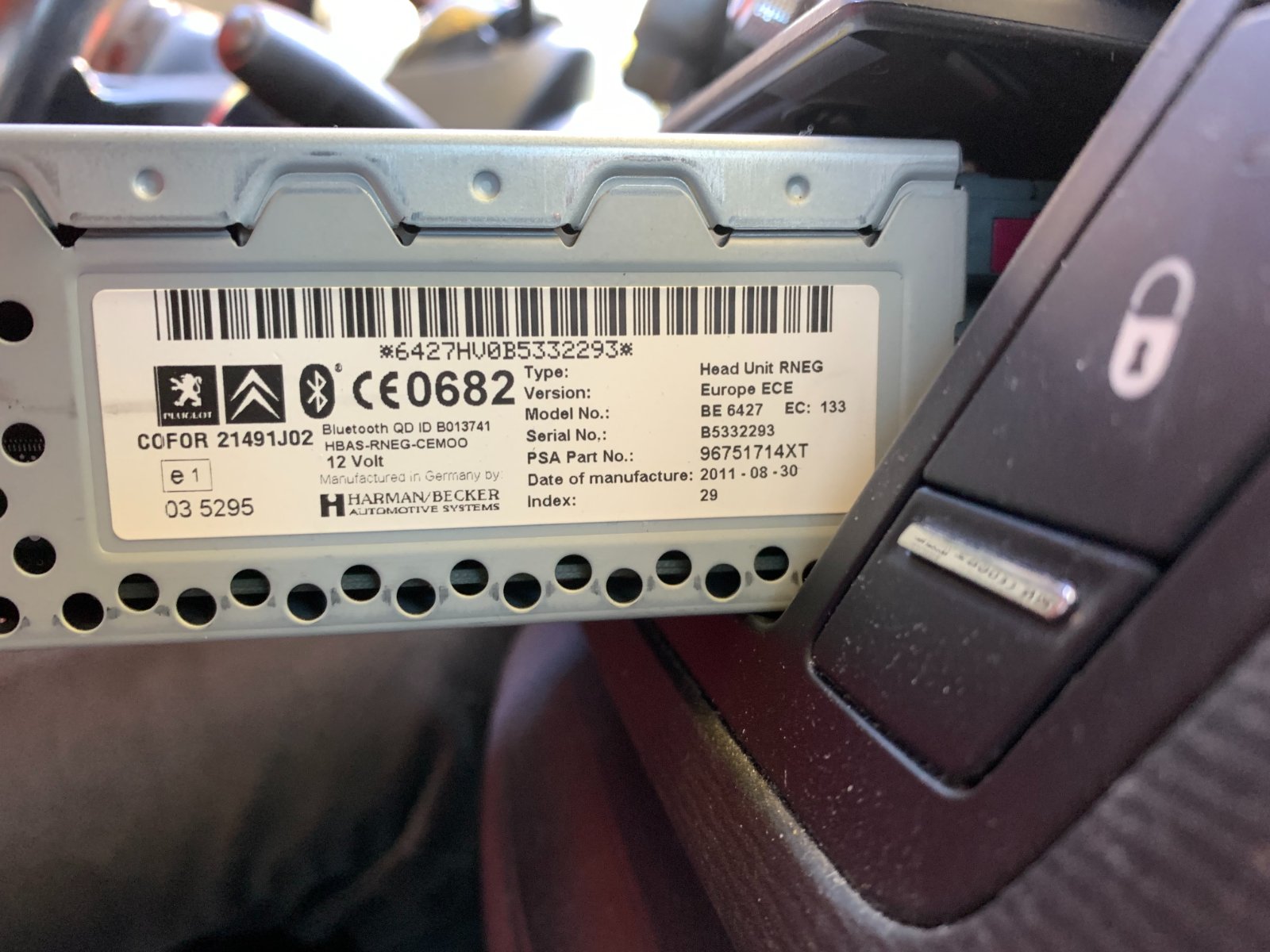

What should I look for when searching replacement unit? There's a lot data on the sticker. What's important to find a matching number and what doesn't matter?

Use the number 96751714XT as per your photo. Just search on this number and it will be the correct hardware. Ignore whether it's from a Peugeot or Citroen - they are all used across the marques.PerTS4 wrote: 28 May 2023, 18:02 Hi Marc,
There are more radios coming from Peugeot 5008 than from Citroen Picasso. Can I use a 5008 radio?
Thanks again
/Per
The Marque can be changed to Citroen if it has come from a Peugeot once you configure the unit for your vehicle. It will need configuring with your VIN number using Diagbox / Lexia and you will need to check the configuration is correct for your vehicle - such things like the type of parking assistance, and of course things like the retractable screen (which some Peugeot models use) is changed to absent etc.
