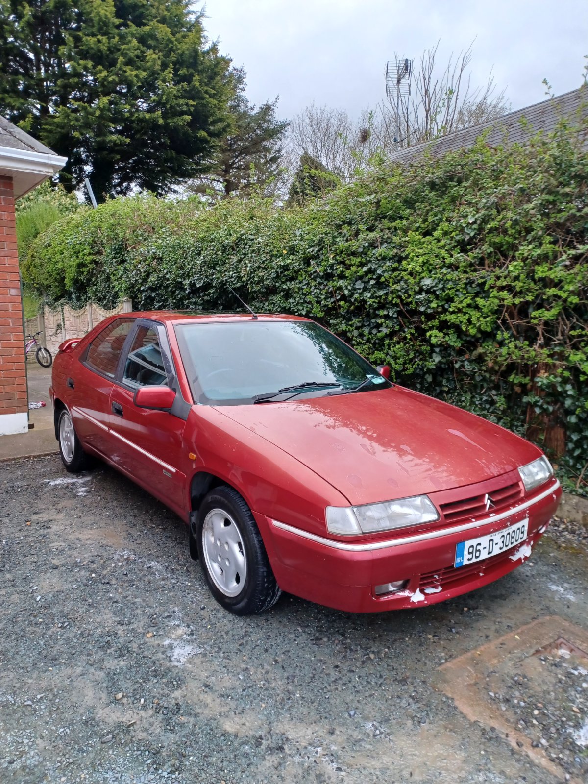

So.... I have just joined the Activa club! I have wanted one since I first sat in new one when I was 16, working at a local Citroen garage.
I found this one up in Donegal a few weeks ago and it would appear to be the last Activa in Ireland. (Republic of Ireland at least). It has been locked away, in a bit of a sorry state for at least 10 years and is a bit of a time capsule, with old tax discs, reciepts and the odd magazine from 2009 in it.
It will need a full respray but the interior will be perfect with a good clean. The engine and box and perfect too but there is a LHM leak of course.
I drove it over 170km / 100 miles yesterday, (with a couple of top ups). Despite a very wet rear subframe, the car performed unbelievably well for a car that has been lying up for so long. 8-)
The nostalgia is putting a huge smile on my face but we'll see how long that lasts when my mechanic gets his hands on it. [-o<
