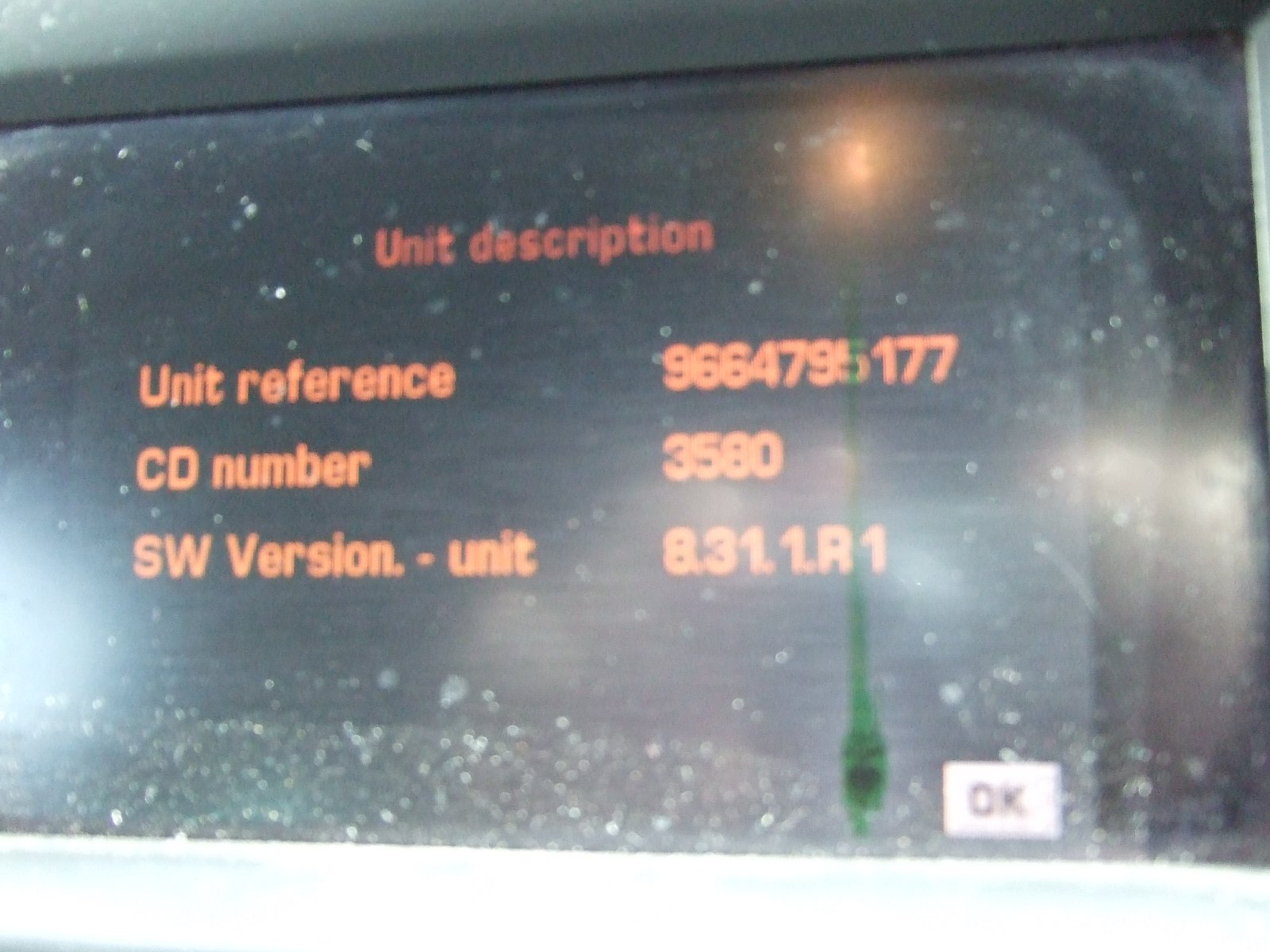

- Posts: 11635

- Posts: 42019
- x 6919
Re: X7 satnav fault. Can I swap it for a used one?
That's the one Peter.
So this shows you already have the latest and last firmware version available installed Peter (V8.31). So whether re-applying the existing firmware will re-write any corrupt files is a chance you may want to consider. The screen does looks like some of the liquid crystal has leaked out, but the calculations for the navigation are all done on the Head Unit. So you likely have 2 separate issues here.
