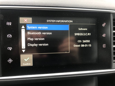

My car is Peugeot 308 SW 2015
One day I thought that will not bad to update SMEG to the latest version. This was a bad idea.

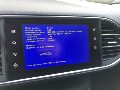

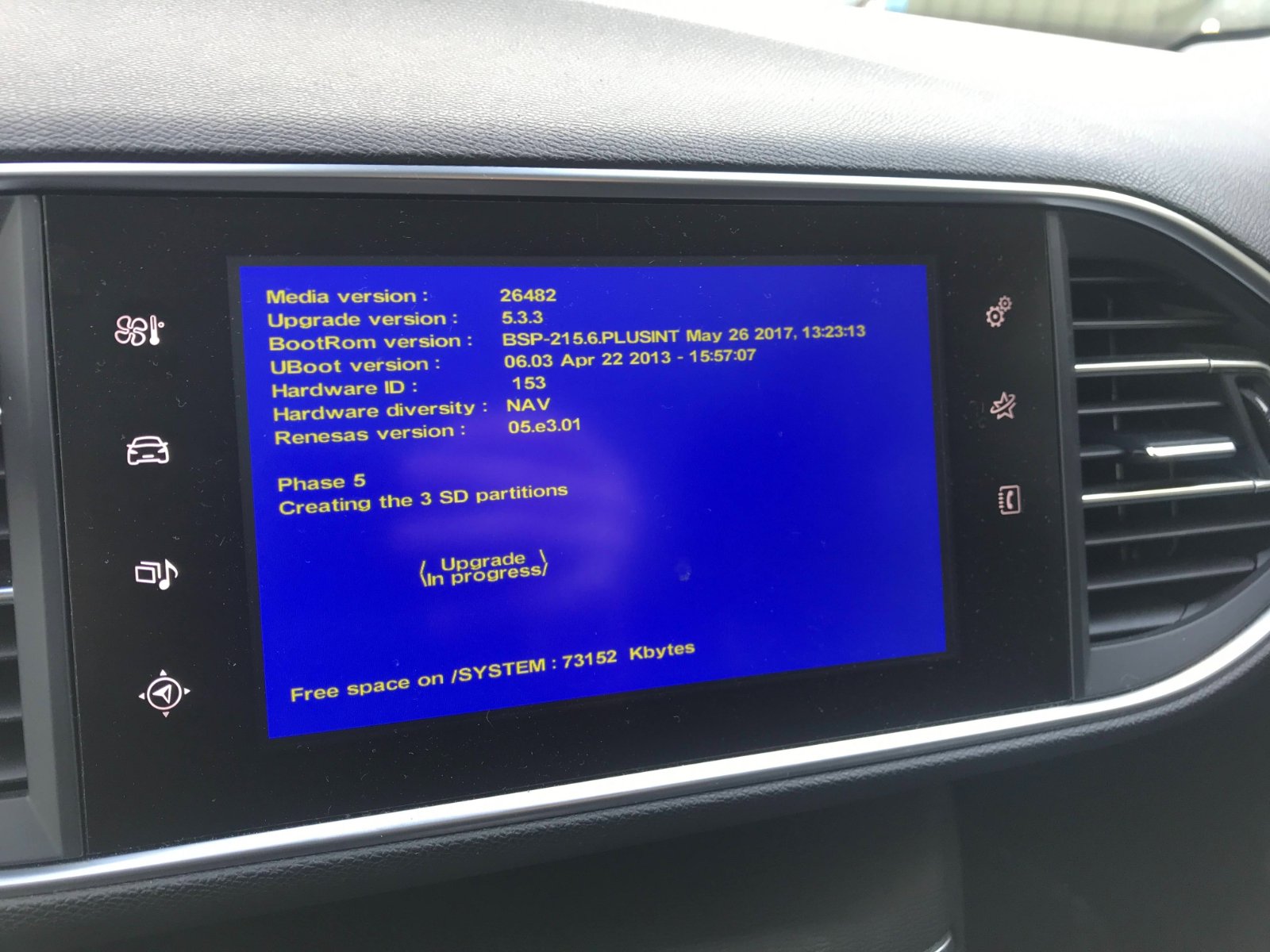

But on "Phase 5 Creating the 3 SD partitions" updating stops or stuck.
Now I have always a blue screen on this step when my car is enabled. All control multimedia systems not working. I tried to disconnect the battery, but after this, I always stuck in the same Phase 5. I think my USB stick was wrong or other issues. But what is done is done.

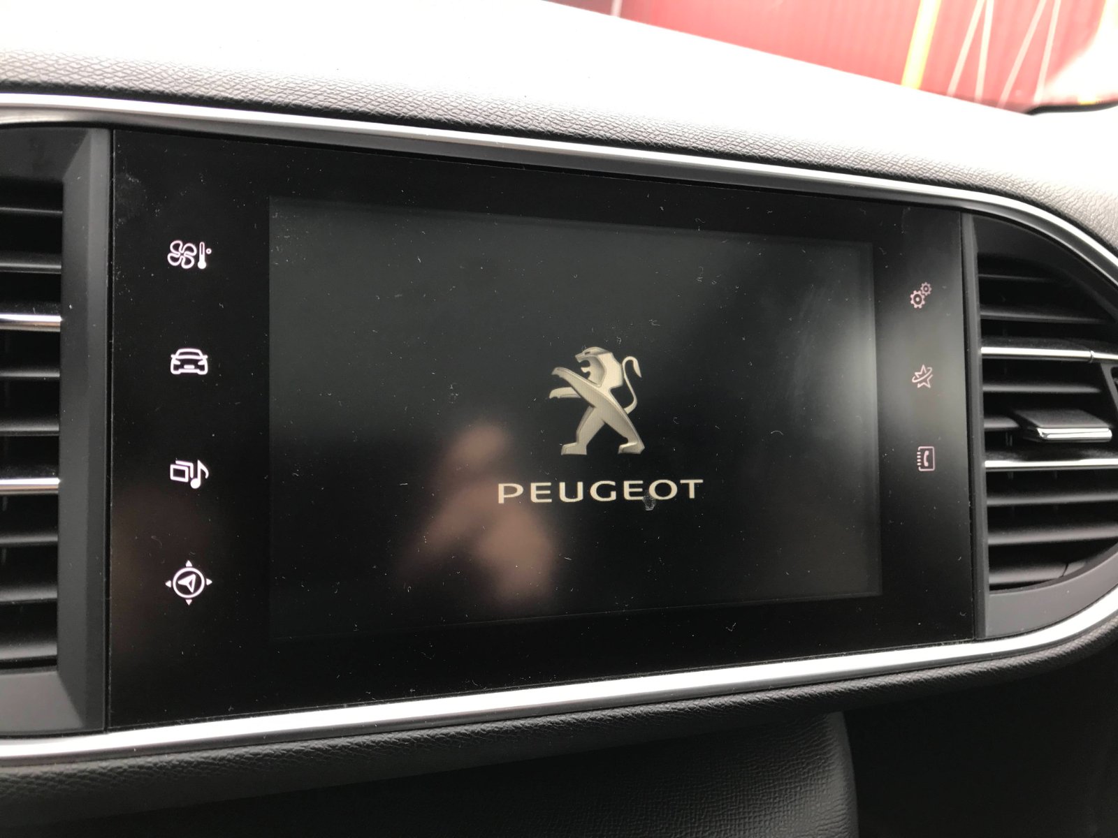

I turned off the car, unlocked the battery after 15 minutes, inserted the flash drive in advance, connected the battery a few hours later, waited a minute, started the car. At the same time, the display remained just black and did not respond, the side icons were not illuminated. The display did not turn on after waiting for about an hour and nothing happened. After turning off/on the car display was still black. After reconnecting the battery and removing the flash drive, the display turned on with the Peugeot screen saver.
When I inserted a flash drive, the display immediately changes to blue, and the process after the test will get stuck again immediately in phase 5. I tried it with different flesh drives many times.

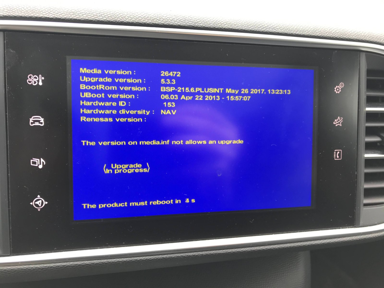

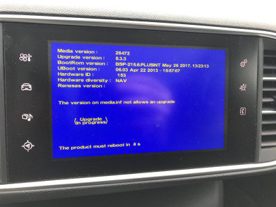

I also tried to put a lower version of SMEG. In this case, I had a message about the impossibility of installation due to incompatibility media.info with a constant loop reboot of the system.
