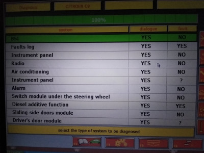

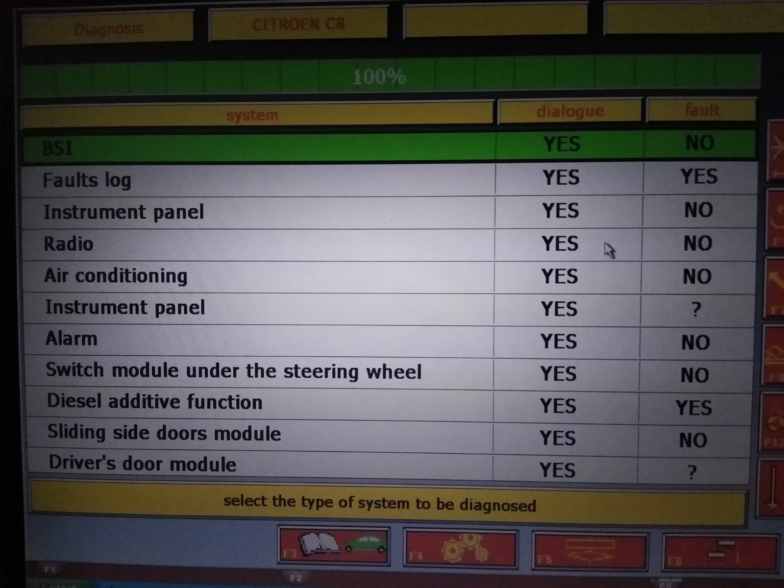

I bought a Lexia device and software and have it all running nicely on an xp laptop. my Car is a 56 C8 and I bought the lexia to enable the aux input on the radio. when I run the global diagnostics test everything seems to report back ok, including the radio which reports "no" faults. Thing is when I then try to then go in to the manual configuration for the radio I get no communication and I cannot get in to the config screen. Does anyone have any ideas?

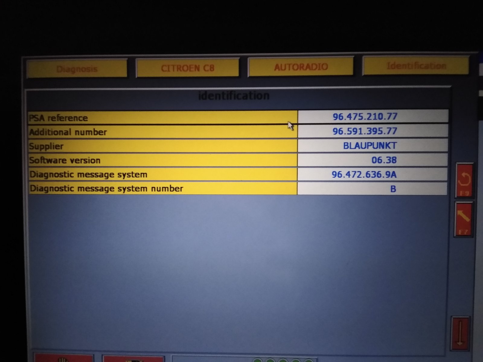

Ok, so you have the basic RD4 system.
What version of Diagbox software are you using? If the ECU has been detected in the test then it is communicating with it, otherwise it wouldn't show up with the detected ECUs.

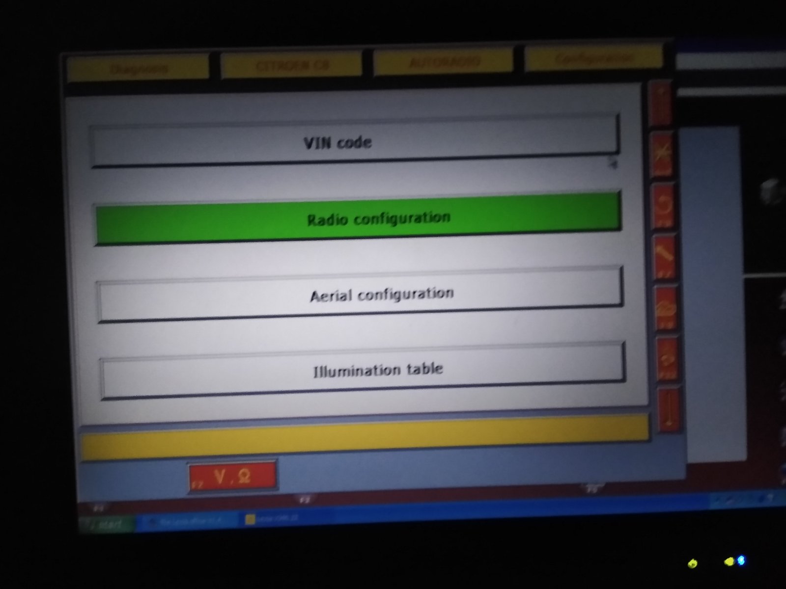

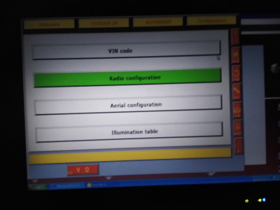

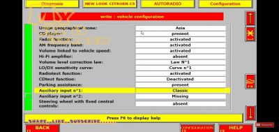

Not sure this is the problem though. I haven't plugged anything in to it yet. The problem is I cannot access the radio configuration page to change this setting from missing to classic. Apparently that's all I need to do. Then when I press the source button on the radio it will switch to aux

Sorry I should be clearer. I have connected the connector to the back of the radio but it is not plugged in to my dab adaptor yet. And the image on the previous post is a still from a YouTube video that shows the setting that I need to change in the radio manual configuration page. The problem is that when I click on manual configuration I get the no communication error
