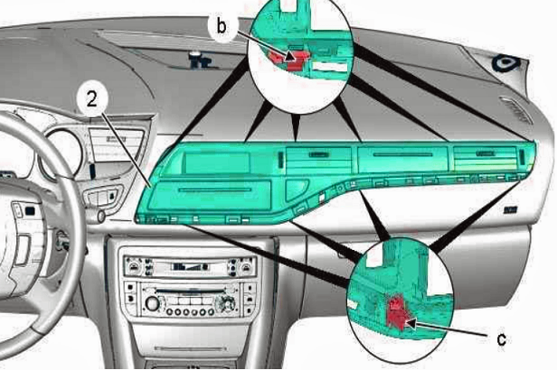

To do that you will have to use some trim removal tools to take of the fascia. It's quite easy - check back in 2 minutes and I'll have put up some pics for you

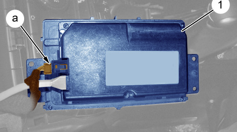

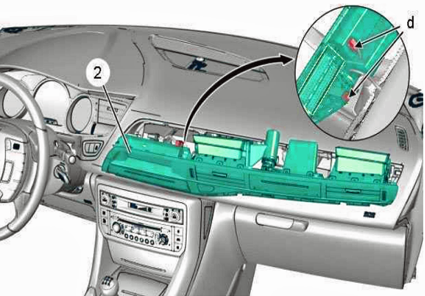

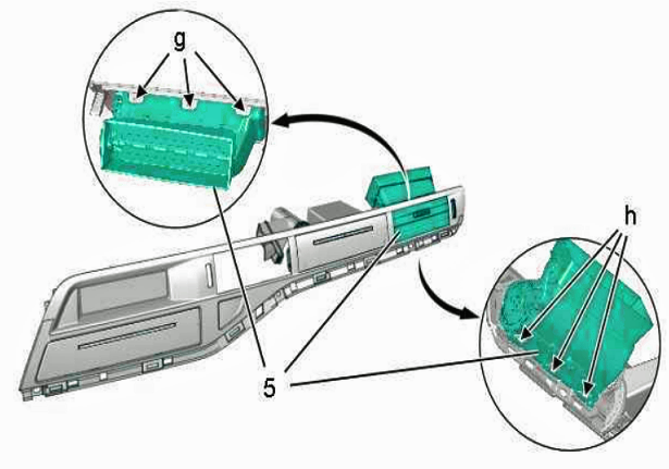

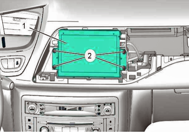

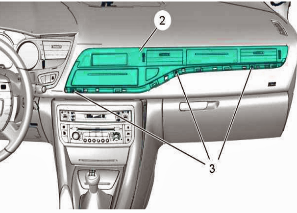

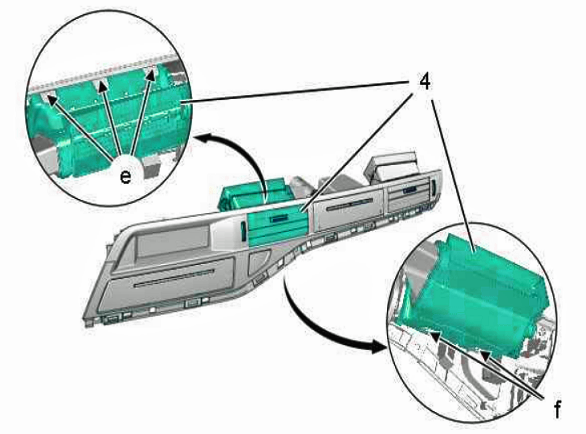

Here you go:
| Unclip the fascia panel front panel trim (1) ( as "a") using trim tools. Remove the fascia panel front panel trim (1). These just lift off carefully with a flat plastic trim tool. | That will expose the 3 bolts shown at (3) that you need to remove. |
| Unclip the fascia panel front panel (2) (as "b", "c"). Detach the fascia panel front panel (2). | Hold the fascia panel front panel (2). Disconnect the connectors (as "d"). Remove the dashboard fascia (2). |
| If necessary, detach the air vent (4) (as "e", "f"). Remove the air vent (4). | If necessary, detach the air vent (5) (as "g", "h") - but you may not need to do this. |
| Remove the bolts (2). Detach the colour multifunction screen (1). | Disconnect the connectors (as "a"). Remove the colour multifunction screen (1). |

No problems - on the top connector pin 1 is the supply and pins 3 and / or 6 are the earths.
Then try and remove both connectors and re-attach to rule out any poor connections.
