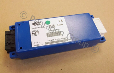

Do you know, does the part in question look like the attached?
Thanks
Mark

The telephone interface module does look similar to that - but it must be the correct part number to be compatible (hardware / software) and may need configuring with a suitable diagnostic tool (like Diagbox with an S1279 interface) if you are thinking of replacing it yourself - but I can't confirm this.
