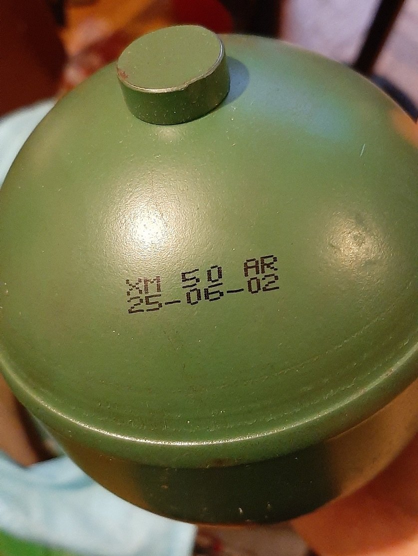

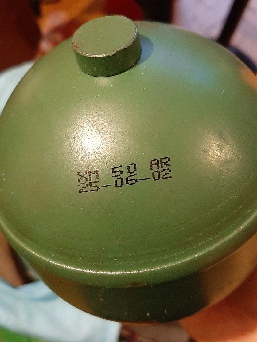

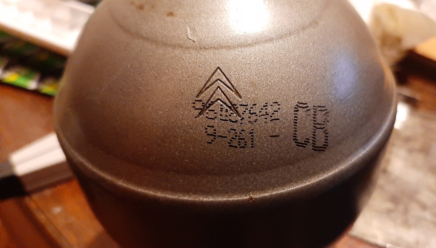

I have a bouncy ride for a while at the rear and obviously the rear suspension spheres are flat, it will be changed next week. I order two Febi 22496 400Ml 30 Bar spheres -which only i can find in a hurry-. As i read previous topics about spheres, it will not a big problem, right?
By the way, all the other spheres will be check and in need/if it's not dead, regassed. By the way, i have two spheres borrowed from my friend, one Citroën gray suspension sphere-not saucer- which i'm not sure i read it's number, because it's stamped right over the chevrons (96087642 maybe?). I guess i don't need it because i've already buy new susp. spheres; but i wonder what for is it, like for BX or XM?
...and an IFHS XM 50 AR (25-06-02, i know, a little(!) old)... But; in need of changing the one who is installed, can i use this? On the catalog of IFHS, the Xantia version is named XA 50 AR; is there any difference? I ask that, because normally i can't find Citroën spheres easily, finding Activa spheres is even harder. I'll order all the spheres i need from EU area -I'm in Istanbul, Turkey- and that's mean that I get it probably after 3 weeks -Waiting for a little drop of the exchange rate is another problem-. I won't harm the suspension or the frame of my Activa; but i had it to use daily.

I will have another go tomorrow to identify your 96087642 sphere.
So far, I've not managed to find that ref no listed for CX, BX, XM or Xantia.
Those 96..... numbers are manufacturing numbers, not part numbers.
A pretty much complete list of them appears in all the Mechanics' Handbooks.

The XM-50-AR is easier. XM rear (arrière) 50bar pressure.
Will check out its damping figure.
XA-50-AR is the equivalent Xantia rear sphere, BUT the damping figure may be different.
The partial detail about these spheres on IFHS and other sites is not helpful.
Only Citroen publish the full spec: eg 400/30/0.8 (cc/bar/mm damping).
So far no joy.

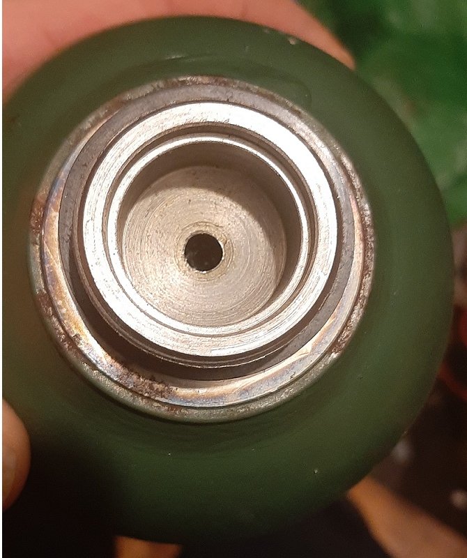

The SC-MAC sphere (on Xantia and XM) is special. It has an internal thread fitting that the pipe screws into. You must disconnect the pipe from behind the sphere before removing the sphere, or you will damage the pipe. So, no, you cannot use any other sphere in this position.

Thanks Chris; i didn't know that these 96... numbers was manufacturing numbers. I looked at the net before asking in the forum, but nothingwhite exec wrote: 30 Jul 2020, 22:43 I will have another go tomorrow to identify your 96087642 sphere.

Yes, i watched a few video and read a lot about it. Just don't know the type of the thread; i've only know the suspension sphere and the regulator sphere-the XM 50 AR- and just hoped that it's the same threadxantia_v6 wrote: 31 Jul 2020, 01:09 The SC-MAC sphere (on Xantia and XM) is special. It has an internal thread fitting that the pipe screws into. You must disconnect the pipe from behind the sphere before removing the sphere, or you will damage the pipe. So, no, you cannot use any other sphere in this position.
I will tell about the pipe to the mechanic, because he hadn't seen any Activa until the last Friday, he don't know anything about the SC CAR. So, lots of photos and translated explanations printed, videos ready on browser or saved to the mobile; he'll get a quick brief before

Sorry, but no joy in finding anything about that 96087642 sphere - apart from a few Ebay items, which are a bit vague about it, and don't (of course) give any good detail (such as damping figure).
The Mechanics' booklet from 2001 covers Xantia, XM, Synergie.
Includes the full spec (cc/pressure/damping) for every sphere on those cars.
The booklets are here:
viewtopic.php?p=590278#p590278
Go to Xantia S2, and hit the '2001' to download the pdf.
Note the note that says that the 96.... numbers there are manufacturing numbers, not Cit part numbers.

The SC/MAC ('anti-sink') spheres does as well, but this thread uniquely carries a large nut, which secures the sphere to its bracket.
The SC/MAC sphere, as Mike says above, is special - no damper, but the large hole is threaded for the 3.5mm steel pipe to connect to it. The thread is the same as other 3.5mm pipe unions. Essential to undo this pipe before undoing the sphere, or the pipe can be damaged if the sphere is rotated.
