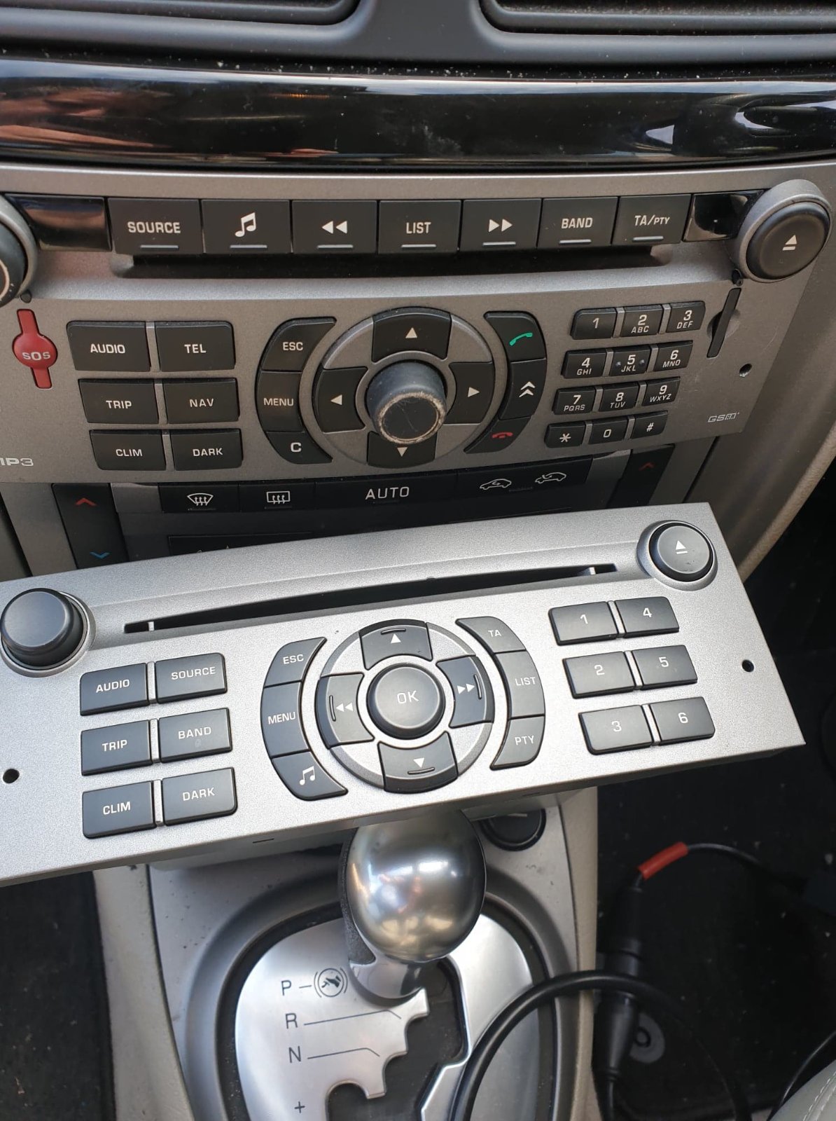

Hi all! In my madness i have decided to add the RT3 sat nav , replacing the small hump non nav radio.

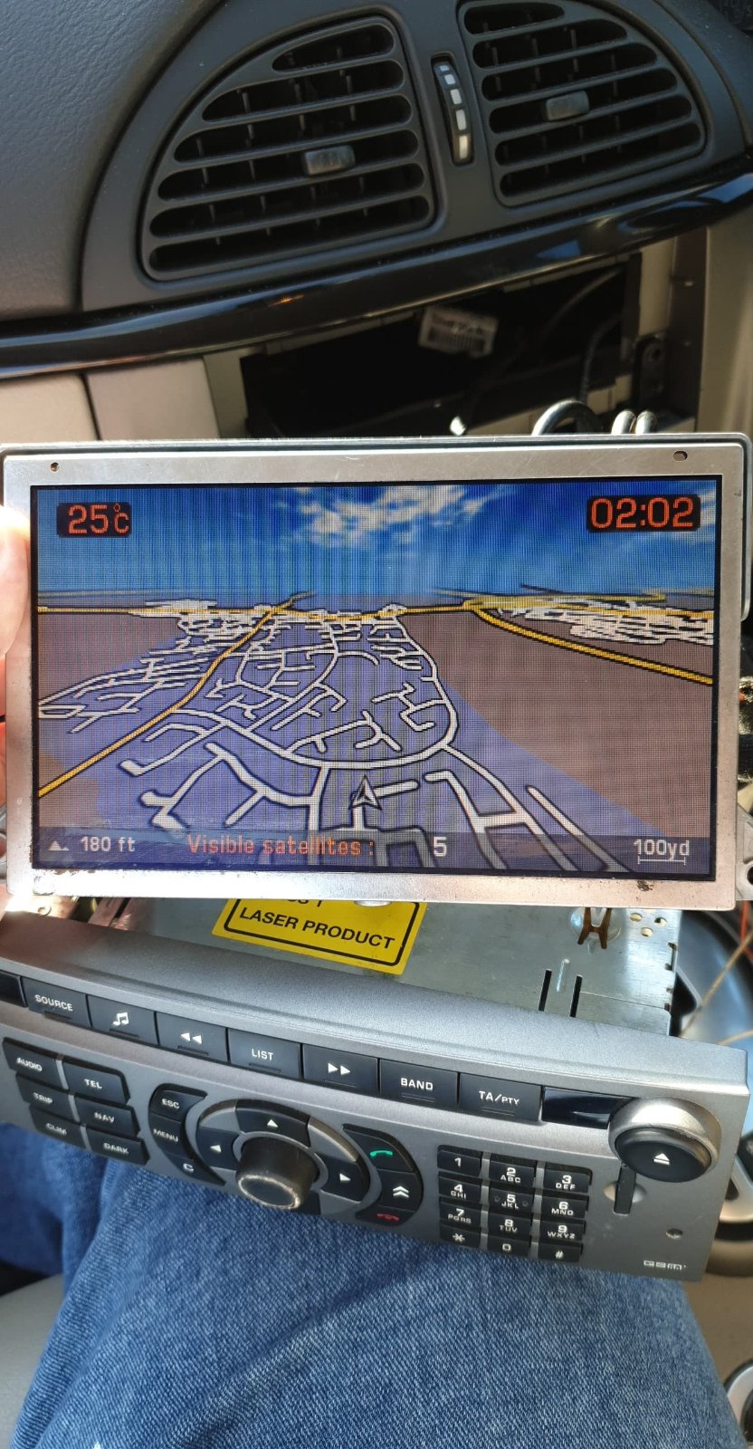

So far so good - cut out the hump, removed the small screen, installed the mount and large screen, checked the radio work (and rewired the 3 small wires to the screen - that all works) and the nav even picked up satellites and the phone.
But - when coming to code it on lexia (the joyful beep) ran into a large block. The radio ecu is not detected and the telematics (once enabled in bsi and as present in the cu section) has a ? next to it. Not sure where to go from here?
