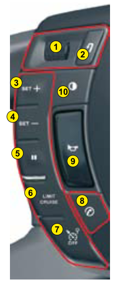

You have the RT4 system, but I can't recall this having a night / day mode for the map display which the later models did, but either way, put your illumination back to the levels you want and activate the Black Panel function.
Press Button (10) on the diagram (at night time or you won't see anything). There are several modes - just cycle through them. First press will cut the dash lighting and instruments and if memory serves pressing again cuts lights to everything except the speedo - but if you press on a control anywhere on the steering wheel (say volume or station search), it temporarily illuminates the Telematics unit again, then reverts back to the previous mode. Pressing again returns full dash lighting. I know on my later Navidrive, that if navigation is active, and I have the Black Panel active, the coloured dot matrix display on the instrument panel will illuminate with the next road turn.
