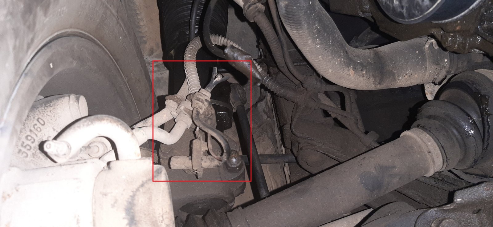

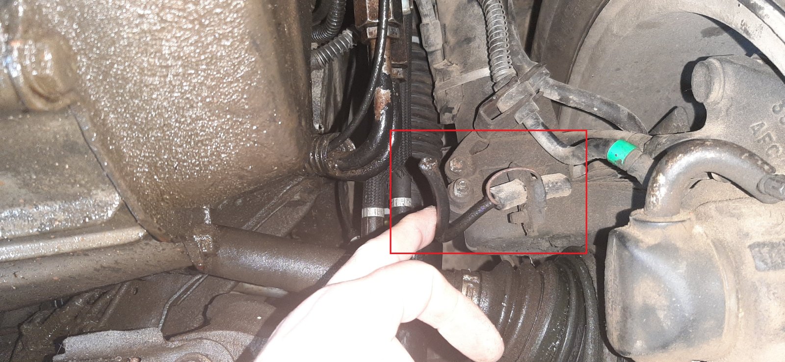

While it was lifted up for underwork, i was at shop too and noticed two cutted wires on the front wheels(Pictures added). The mechanic says that is a check sensor for brake pads; if the pads are near at they end, the sensor alarms the driver and because of routine checks, it isn't necessary and mostly cutted on Xantia's. I search the forum about any sensors on the front wheels, but only find some ABS sensor topics on the rear(About changing the sensors, there was an explaining about the front sensors too but no picture).
Can anyone tell me what for these cables are; are they really unnecessary to use etc? Because i doubt that is for ABS or maybe a wheel angle sensor or something, and with cutted sensors they will not function properly. (By the way, the mechanic uses a Delphi diagnostic software and there isn't any error about the brake sensors).

I think those are, as your mechanic says, the brake pad wear wires, there isn't a sensor as such the wires plug into holes in the pad backplate and protrude towards the disc, when the pad wears too thin the end of the wire touches the disc and switches on the brake warning light.
It won't stop the car or the brakes working if they're cut but you wont be warned when the pads need replacing.

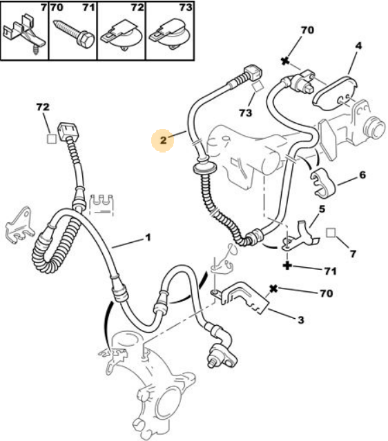

Just for recognition purposes, these are the ABS sensor cables (1) & (2).
The smaller wires (in your photo) will be the brake pad sensor wiring.
You'll also have the handbrake cables there too (not shown)

Your mechanic is correct, those brake pad wear indicator cables often break due to the flexing as the suspension moves up and down. The original wire is not flexible enough and the copper breaks through metal fatige, then the plastic covering breaks also.

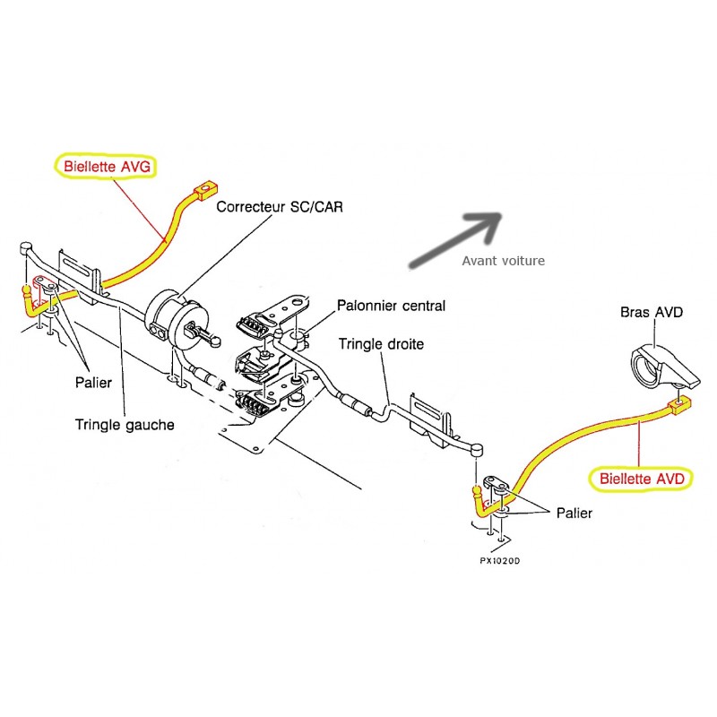

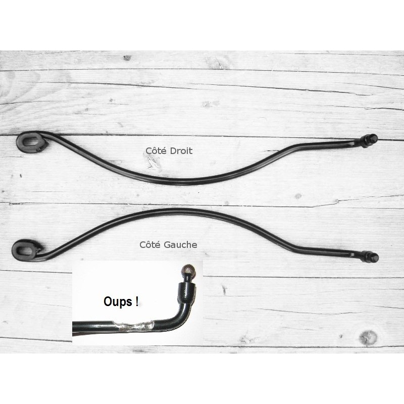

Your car needs the Activa rods adjusted and will (most likley) need new Activa Rod Bearings.
Setting the ACTIVA (SC CAR) system
http://www.activa-club.fr/documentation ... f-sc-car/
Shop ACTIVA Club.fr
http://www.activa-club.fr/ActivaShop/en/23-pieces
Part called ---Palier---
Also check there is zero thinning of the control rods

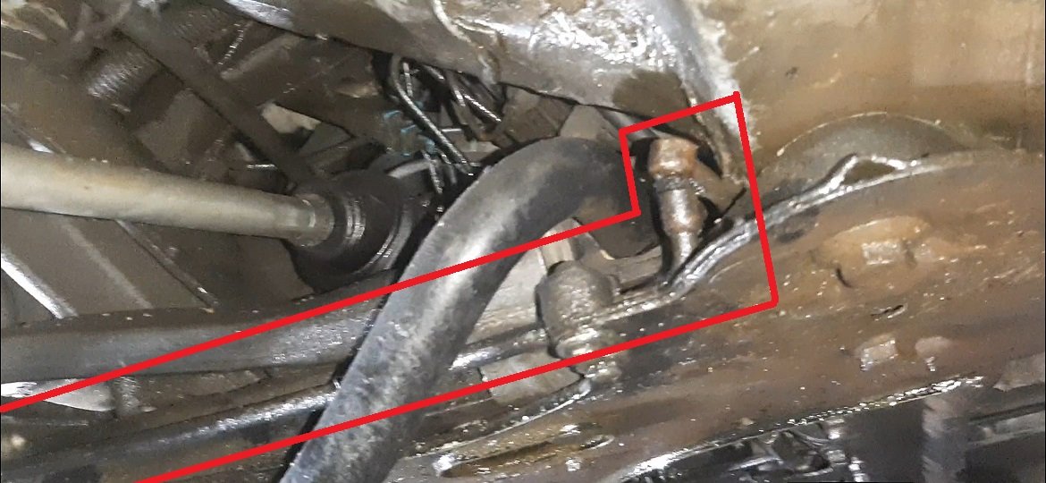

By the way, i watch the video that i take underneath, i think this one of the Activa rods that you mentioned. I didn't know that i should check it deeper
