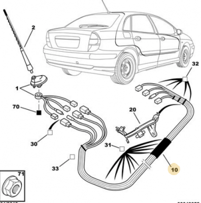

Hi Everyone, I am a new member on here having just purchased my 3rd C5 which is a 2001 2.2 HDi Exclusive hatchback, When I bought it I discovered the (Everything Works!!!) radio does not receive anything and the gps does not work. From memory and a read on here I was pretty convinced that the antenna was faulty so I decided to remove, clean the amp cards etc and refit. No change so I decided to replace with one from ebay. I found a likely candidate and I have purchased it with a new wand, they are still to arrive, but I noticed a difference between mine and the new one. My unit has 4 leads coming from it going to the connector holder under the roof lining which I assume to be GPS, FM/AM, Power, and a single wire which I think is a ground wire. The one I have bought does not have this, with only 3 leads, so I assume it takes the ground from the coax sleeving. Can anyone throw any light on this?

For a start, post you VIN up here so we know what system was originally fitted - I suspect it is a first Gen. Siemens VDO - which are no longer supported of course. But also, put up some pics of the new unit or a link to the seller so I can determine what it is you are trying to replace it with. You haven't mentioned the GSM Aerial which would also be there for some models....

Ok, so the correct aerial for your C5 is the following one:
Part number: 6561H8. These are no longer available from Citroen now, of course given the age of the vehicle.
You'll find that the aerials have aerials fro FM and AM, GPS and of course the GSM for where the telephone option is fitted. As you say those ebay links no longer link to anything, so I can't tell what you have as a replacement unfortunately.

Update: In light of what Paul has said, I can now see that the aerial you have purchased is for a MK II C5. These have completely different Head Units and Telematic Units, so is not designed for the earlier model.
