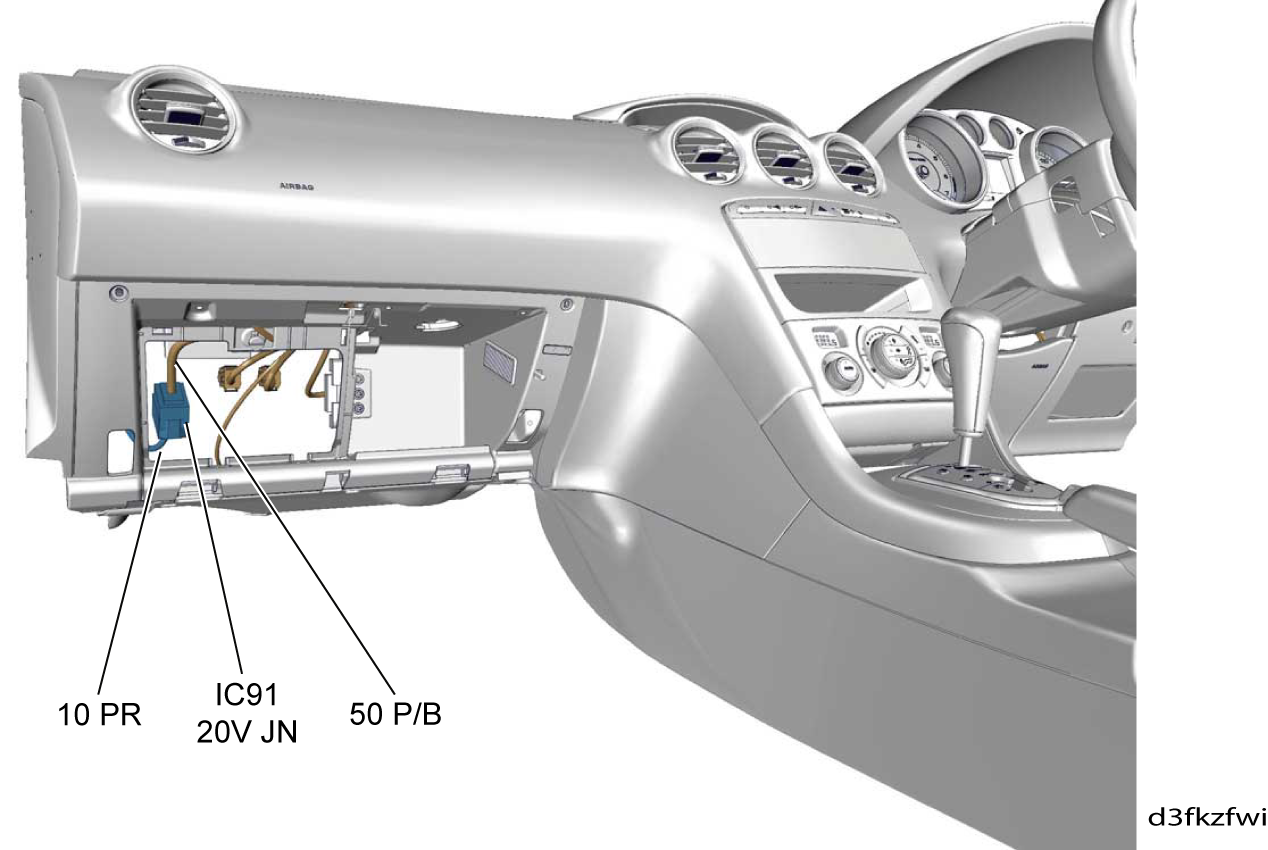

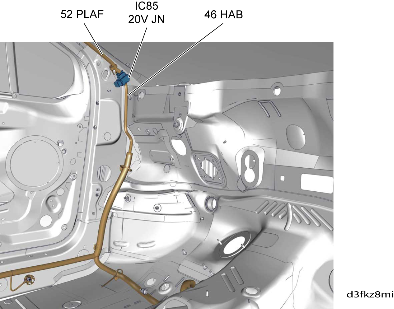

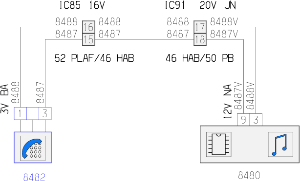

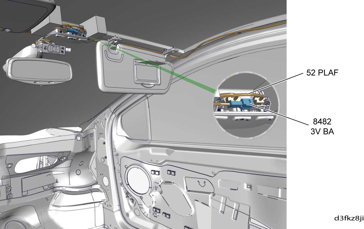

xantia_v6 wrote: 08 Dec 2018, 17:25 Having done a bit more searching, I have realised that the 308CC and RCZ have a piano-black (glossy) finish on the radio facia, so the replacement RD45 is a bit rare.
Can anyone tell me (or point to a picture of) the location of the hands-free microphone when factory-fitted to a 308CC?
This is the location of component 8482 : radio telephone microphone and its interconnects on the way to the back of the stereo according to SEDRE. Having said that, not sure how much the images look like a CC! 8482 : radio telephone microphone
IC85 : passenger compartment harness courtesy light harness interconnection
IC91 : fascia harness interconnection with passenger compartment harness
