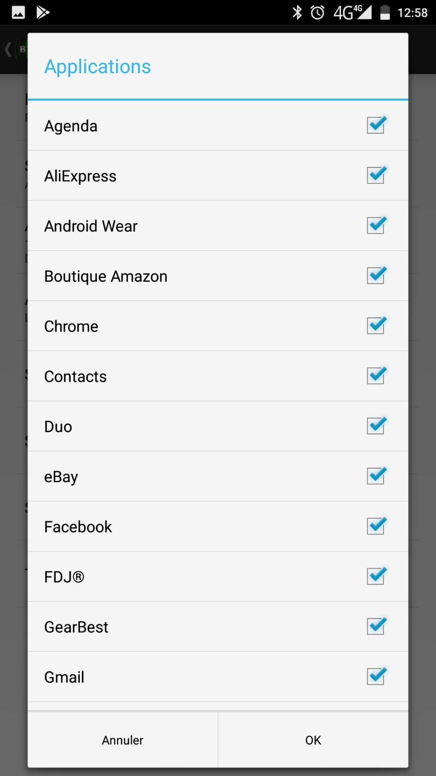

5/ Notifications : list of applications
Just tick what application notification will be read on the NG4
