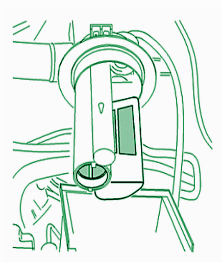

Ok, so here is the Filter component - incorporated into the LHM tank. There are documented cases where cleaning the system out especially the filters has cured rear sinking issues with electrovalves, so if you have eliminated other possibilities I strongly suggest you clean the filters out - there are surprisingly, a lot of Citroen 'specialists' that still don't know about the filters and the impact this can have on the system when blocked. Blocked filters can put a lot of strain on the system as the oil is trying to get back and forth and if you haven't done this in your ownership of the car, then you can't also guarantee that it has been done previously.
There's a guide on cleaning this out here, with photos, by Andrew:
Cleaning LHM Filter Guide

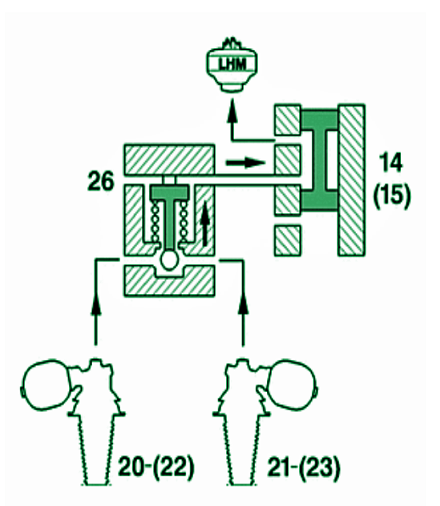

As for the roll control and firmness, here's how the valves work:
In the "firm" mode, valve ( 26) enables the vehicle roll to be avoided.
It prevents the transfer of the LHM fluid between the 2 suspension units.
When the vehicle is rolling, the fluid tends to pass from a suspension unit to the other; this causes the ball to move and block the passage; the suspension units are no longer interconnected.

"Fluid Admitted" Correction
The height corrector is in the "fluid admitted" position.
The supply pressure from the height corrector pushes the ball to the bottom of the valve.
The suspension units are supplied by the corrector.

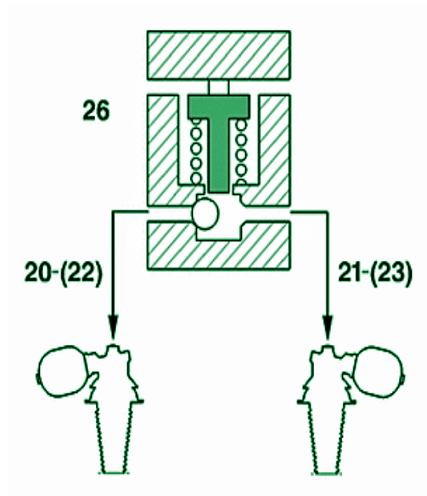

"Fluid Expelled" Correction
The height corrector is in the "fluid expelled" position.
The ball is released in the valve housing.
The suspension units are linked with the hydraulic fluid reservoir.
