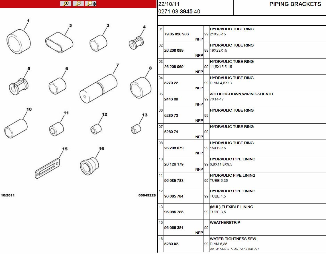

Small high pressure pipework uses special LHM 'rubber' sleeves for the screw-in unions, identified by a longitudinal green stripe.
Citroen part numbers for these standard small seals are really difficult to find on Parts - they're hidden under Piping Brackets! #-o
#11 96 085 783 Hydraulic pipe lining Tube 6,35mm
#12 96 085 784 Hydraulic pipe lining Tube 4,5mm
#13 96 085 785 Flexible lining Tube 3,5mm
Usually available each, or in larger packs.
