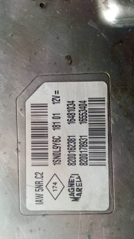

I had the car computer to a specialist to remove the coded ignition but he said it can't be done with this computer...
EDIT: Image of the computer
