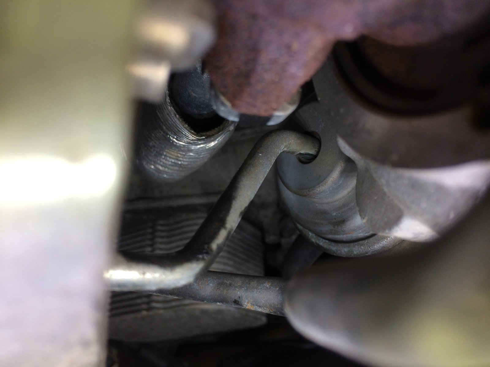

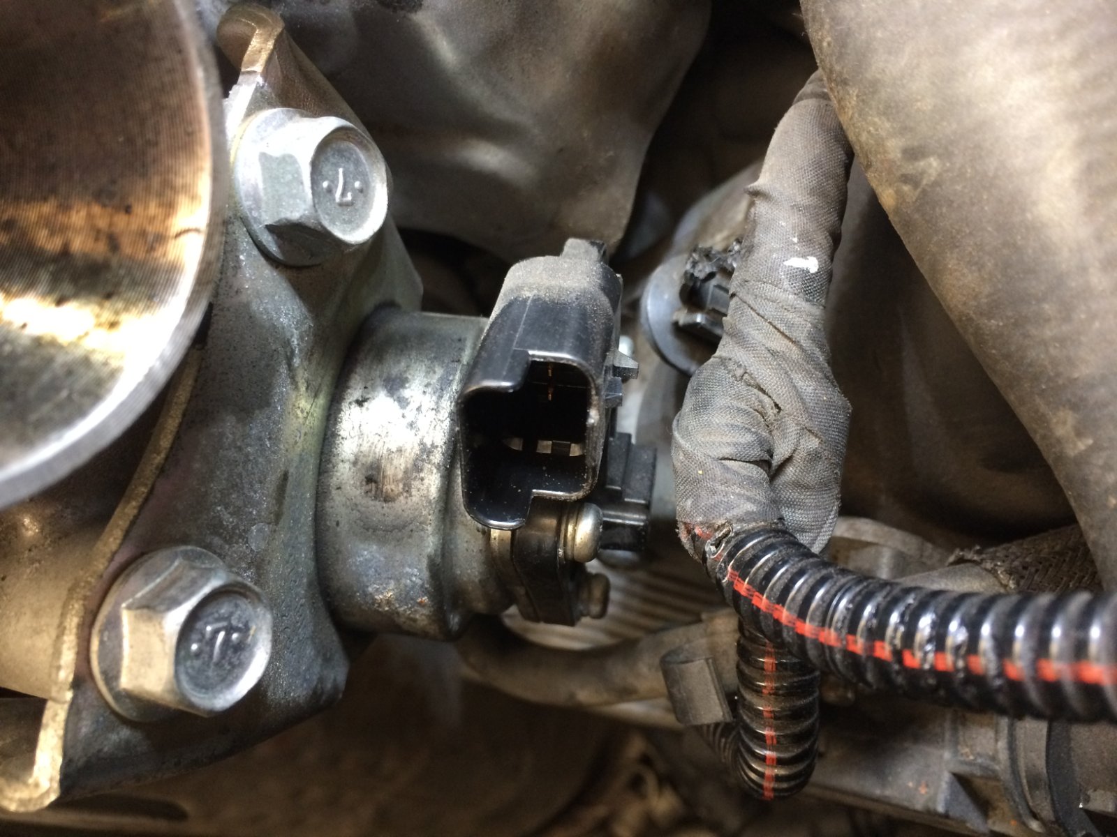

My garage friend pointed me towards a unit just below the turbo intake pipe, which he thought was the faulty part. I have attached two photos (if I can manage it): one shows the end looking towards the middle of the engine (Turbo inlet tube above) with the socket where the wires connects and the other shows the other side showing the control rod coming out of the unit, which presumably controls the turbo. I'm not sure what part I am looking at here and if it it is the one responsible for the fault. Can anyone shed light on this for me please, and hopefully an appropriate remedy?
